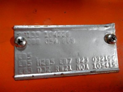

here is a picture of the fender tag. It has some odd strange numbers on it and it isn't painted. Did they ever come out of the factory unpainted? Does it look real?

looks good, but anytime I see price not listed it usually means over priced.all the fender tags I've seen have been painted. the stampings on that one look soft, unlike the factory ones I've seen.

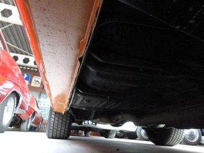

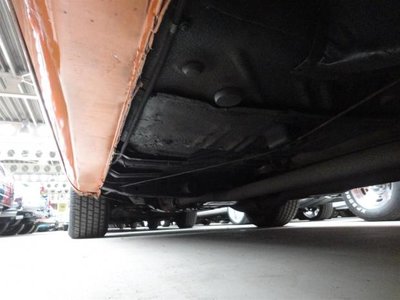

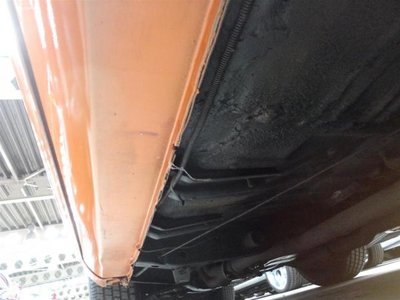

Hi guys.
Some more pictures of the 70 RR.
Thinking of going over the channel to take a look at this one. The GBP to Euro is great at the moment.

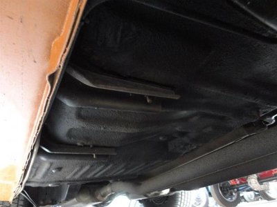

Some more questions for people in the know.
Does the underside look OK.
Sills?
Body seam?
plym Road R (2).jpgplym Road R (3).jpgplym Road R (4).jpgplym Road R (5).jpgplym Road R (1).jpg

I like the '68, has rear arm rests in the front. Sits awful low for having air shocks. Killer is not being able to see it first hand.
The '70 looks good, but pictures only show so much. Be worth looking it over.

Back to that fender tag - what colour code is on it for it to be Vitamin "c" colour. It looks to me like the letters and numbers on the tag are "EB5". What colour was that?

I don't know the code for Vitamin C, but B5 is blue. '70s are a one year only on a lot of the parts, so that can be $$ to find replacements.

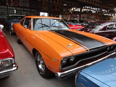

Right guys.
Just returned from the trip to Amsterdam. It's been a long day. 2 flights 2 intercity train journeys and 2 half hour taxi rides. ouch!!

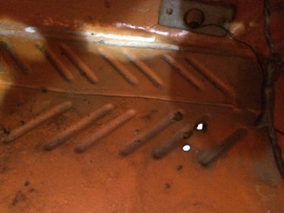

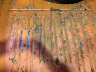

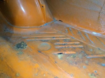

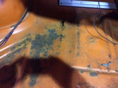

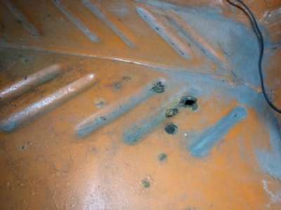

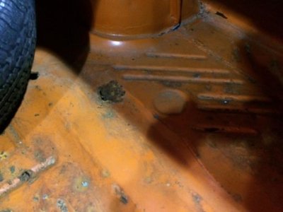

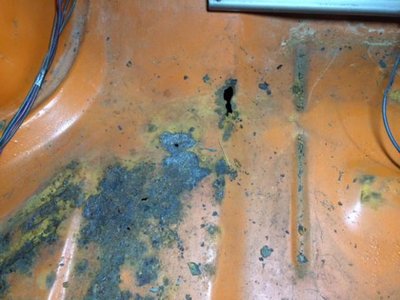

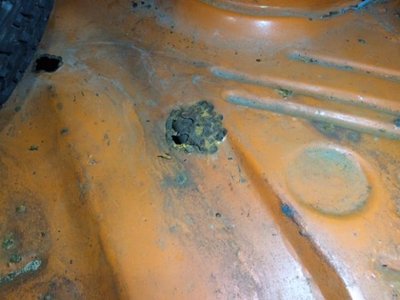

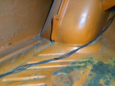

Firstly, as I went into the car showroom and saw it for the first time it looked great. Then I opened the trunk and my heart sank :(
There was quite a bit of rust on the trunk floor and maybe 6 or 7 clear holes that you could see daylight through. (see attached pictures)
I had a good look underneath and to be fair it looked pretty good. Quite a bit of oil thrown around though from a leaky oil pan ( I think) a bit of surface rust here and there but nothing really bad.
Inside was OK but not great. A couple of seams in the front seats are split. The centre column is really loose also (is this normal?) The doors closed well enough, as did the hood and trunk. The "air grabber" isn't working.
Under the hood looked OK but quite a bit of surface rust on things like the brake master cylinder.

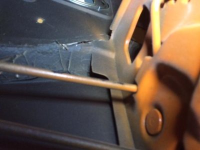

I got in the trunk and had a look under the parcel shelf where the speakers are. (see photo). Not sure whether what I saw here is right or wrong. It looked ok.
Where the trunk weather seal sits is corroded on the lip all the way round and I couldn't see the numbers that are supposed to be on there to match the VIN. Too much rust.
Right - so I took her for a test drive. Fired up ok from cold and engine sounded ok. Nice Mopar sound!
Auto box shifted up and down ok and engine did seem strong.
Brakes not so good. Had to really push hard on the brakes (front disk and rear shoes) to get them to work and then it locked up the front left and veared left.
The guy said it hadn't been run for a while. Hmmmm??
So what now? My gut feeling is to look around for something better maybe. This IS the first one that I have looked at in the flesh so to speak. There just aren't many around in the UK.
There is another guy in the UK (only about 70 miles from me) who is selling a 1970 GTX 440 sixpack with matching numbers engine but he wants more than I want to spend. I think he wants 27k GBP (about 40k USD).
Maybe I should go and look at it, if only to compare it to the RR that I have just seen. (do you know what I mean?) The GTX is supposed to be in a very good condition.

My trunk was pretty badly rusted (only part of the car that was), but it was all surface rust. I scraped and wire brushed it, then painted it which Chassis Saver and then painted it. It is rough, but solid (and hidden under the vinyl trunk pad). THAT one may need a new panel welded in.

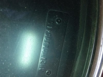

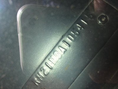

the dash has been painted, the vin tag should have a white Chrysler Corporation decal on it.
I've seen worse on the trunk pan. To be as nice as the rest of the car does, it should be replaced, but you could clean and paint it and worry about it another day.

The vin numbers on the trunk rail are under the trunk weatherstrip, which if it's glued down as it should be, you couldn't see them.

If your gut is telling you to keep looking...then listen to it. Keep looking and saving your money, and get the nicest car you can. and not a bad idea to look the GTX over just to compare things.
