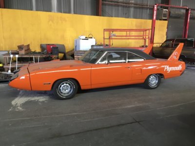

both super birds are all there and the 68 is also ,taking a look at the fender tag to see if its close to mine since both cars were purchased in this area .the guy said he would take 40,000 for both super birds and when I called back with the money he would not answer the phone , I wonder if he got cold feet or a better offer ? probably was to good to be true anyway.all I can do is keep trying to call him.
Did you see them in person. Maybe someone else gave him a better offer. I don't know 20 grand apiece the money it would take to restore them would be out of this world. That is unless you have unlimited fund's. If you know where he lives might just camp out on his lawn till he talk's to you.
my luck I would go to jail for stalking. lol I did meet him so I will watch for a vehicle in the yard. Its funny all three of them are less than 7 miles from my house .
