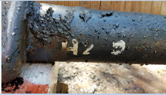

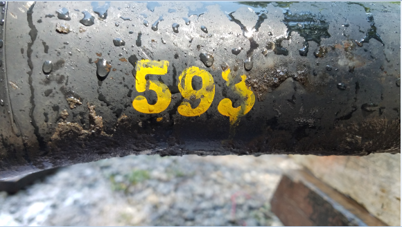

I pulled it out.
Negative on the Sure Grip.
Oh, so on line 2 there is a "S/G" missing?
No worries though.
I wanted taller gears with a 742 and bought
Even the marks were pretty well preserved.

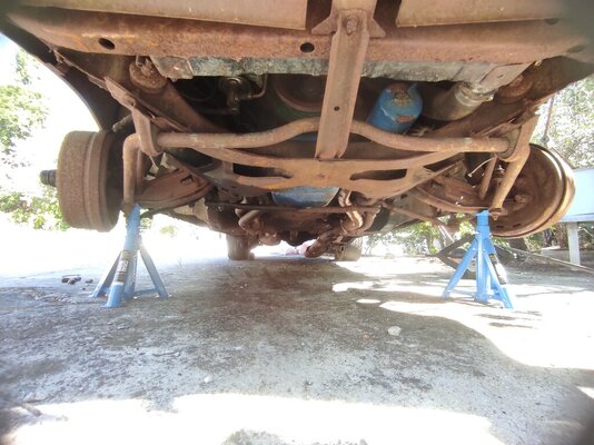

I raised the front today to change the dacades old blown front tires so I can move around the car when needed. I can't remove the tires from the rims myself for my life. They're extremely old and are pretty much stuckon the rim.
The lift points are in the worst condition of all the rails since they're right below the front floor boars so I chose to put the jack stands under the lower control arms. They're sturdy and it simulates the road load. Do you think I can leave it there for a couple of days until I find a shop to change my tires?
Later I will jack the rear also (maybe from the axle?) To start cleaning undercarriage rust, remove the gas tank etc.

Jack stand on the LCO not a problem.
You say can't remove "tires" ????
Do you mean "brake drums"?
I see the back tires on the ground.
You know about the left hand thread studs on the drivers side, correct?

Sorry I should have explained better. I meant can't remove the tires from the rims, so I'll have a shop do it Monday. And I was wondering if it was ok to leave it like that and later with 4 jack stands for extended periods of time.

Yes.
Some people actually say don't let a suspension "hang" for an extending period.
In other words, jack stands under the rear axle and LCAs are preferred to jack stands on the frame frame.
The car is supported on it normal points then.
I don't think either is a big issue really.
And since you probably will go through the suspension anyway, it's not important.
(Leaf spring fasteners should be tightened with the rubber bushings in the loaded position.)

can stay on jackstands for quite a while. Bigger issue might be why is drivers wheel pointed one way and the other one pointed differently.
other recommendation, get stronger Jack stands. If I’m under the car, those make me nervous

I noticed that too. I don't think it was like that when it came here. I actually towed it to that place about a kilometer and it was rolling pretty well.
I wouldn't get under the car like that either! Not without a couple of cinder blocks and more stuff under there. But the jack stands look very sturdy to me, and specifically got ones with pins to be safer.

Use big blocks of wood under the frame rails. I never seen wood crush. I used 8x8 timbers and did not have a lift supported the car in four places on each side. The car was well over 16 inches off the ground so I could use a creeper to do my work.

I would not use cinder blocks. They can easily break. Like Russ said use timbers, they are much stronger and short sections (around a foot ) are almost impossible to break. I use 6x6's
So that turned out to be a visual trick of the phone camera! The wheels are parallel :p

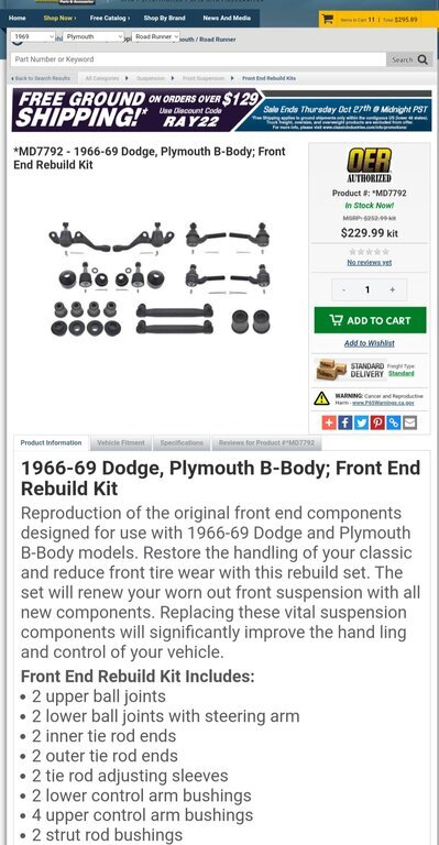

Question, do I need to remove the K-Member and therefore the engine to remove the front suspension?
I was thinking of adding this front suspension rebuild kit to my order. And the rest of the front suspension, brush the rust, clean, rust convert and paint black.

There is no need to remove the K-member to replace the front suspension. That looks like a nice kit, but I prefer to use Polyurethane bushings, They have a lot of advantages over rubber with the only disadvantage being that they transmit more road noise and vibration to the interior. Here's the kit I'm looking at.

I agree on the polyurethan bushing for MOST things.
But.........
This is over seas and he needs "simple" for several reasons.
A kit from a known source maybe?
For example. I buy my "hard" stuff separate. I try and get Moog "Made in USA" for that.
Sometimes I even order from the local parts store and eyeball it when it comes in.
And I piece together the rest.
That kit you gave is not listed for a 69 and are you sure the seller is fool proof for fit?
I can't.
If you can, fine.
But I still don't see the strut rod bushing in it.
I have yet to use poly strut rod bushings.
It doesn't have any compression.
I always use rubber for that.
It WILL compress as needed.
And I wonder if his "sleeves" are reusable.
The bushings don't come with them it seems......................
http://www.heritech.org/cuda/bushings.html
The Classic kit has something though.
Rubber?
I try and buy stuff from MOPAR people as much as possible.
Ebooger is a good source, IF he has it.
His stuff will always be right.
But again, overseas??????
https://www.ebay.com/str/ricksmopars
On top of all that the poly can be more difficulty to install.
