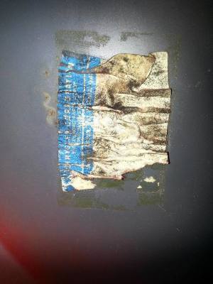

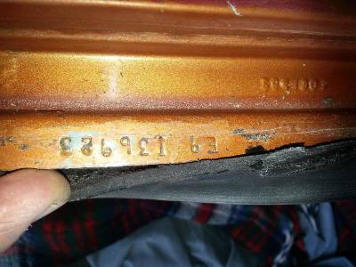

So knowing this it still gets my brain going wondering if the rest of the car is 69 or 68? Is it possible for someone to go to these extremes to make a 68 a 69? Vin sequence is on the radiator support and rear fender rail, but would someone back in the day go to these extremes to make a fake?
Here is some background as to why one would think maybe this is a 68, When I got the car in 2010 it was missing the front bucket seats, among many trim parts, the rear bumper was from a 68 although the reverse light wires were just dangling there, and the 727 has the 3 prong NSS and is wired right at the starter relay. We know the car was in an accident as the rear passenger 1/4 was replaced, with a factory one from the old San Leandro,Ca parts warehouse. (Sticker still on the inside of the fender :) On the drivers side with the correct sequence # there is chipped away paint around the rear tail light bucket down to metal, the other side is down to the original paint,(now has a 80's earl scheib respray) 383 was not original but correct for the year. 727 seems to be correct so does rear end.

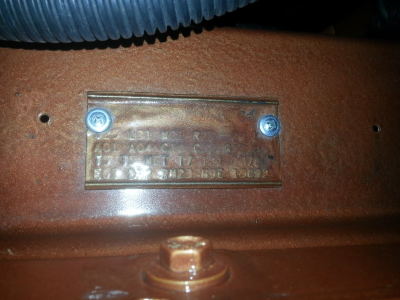

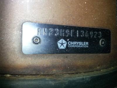

Vin:
RM23H9E136923
Fender tag:
My 1969 Road Runner Fender Tag Decoded
Decoding of Fender Tag: Botttom to Top, Left to Right
Code Description
E63 383-4 Barrel
D32 H-D A-727 TorqueFlite Trans
RM23 R = Plymouth Road Runner M = Medium 23 = 2 Door Hardtop
H9E H = 383 330HP OR 335HP 1-4BBL 8 CYL 9 = 1969 E = Los Angeles, CA, USA
136923 Sequence Number '136923'
T5 = Paint Code: Fire Bronze Metalic
M6T Trim Grade/Style/Color M = Medium 6 = Vinyl Bucket Seats T = Saddle Tan
T7 Upper Door Frame: Saddle Bronze
131 Date Built: 1 / 31 / 1969

There's several key differences between a 68 and 69.
In the body, the quarters look similar, but are quite a bit different. 68 panels are shorter and the rear panel where the quarter welds to (behind the tail light) is different to allow for the length.
You car being built after 1 Jan 1969, the rear panel the bumper bolts to will have a oval cut out around the gas filler. 68 and early 69 are round.
I looked at some pics and I got a glimpse of the head liner... 68 and 69 is different... Yours is a 69.
To answer a question, yes, it is possible to make a 68 into a 69. I helped someone change a drag car (change in class). It's a lot of work though.
Your car is a 69. Tell whoever is whispering in your ear that it's a 68 to STFU.

It would take a lot more work than just a rear bumper to make me think your '69 road runner was made from a '68 road runner <-- '68 ROAD RUNNER being a key here. First thing I would look at is the floor pan for original factory bucket seat mounting as the '68 ROAD RUNNER didn't have a bucket seat option. Next both fenders and rear quarter marker LIGHTS would have had to have been replaced with rectangular reflectors and the wiring harness would still have the marker light pigtails. A small detail would be that the front bumper parking lights would go out when the headlights are turned on for the '68 models. (I think this was due to the current draw for the side marker lights and the headlights together....only my theory). Next the upper and lower dash pads would be different, the fuse box and access to it on the '68 is different than the '69, the door lock buttons are toward the rear on the '68 doors versus the '69 and '70's. The spare tire hold-down in the trunk is different on the '68 versus the '69, (the '69 has a bolt as a pivot for the wing nut hold down rod). The under hood fender attachments to the radiator support are smaller and if there was a emission label with the idle speed and ignition timing still there or an outline it would be between the washer fluid bottle and the radiator support on the passenger's side on the '68 as there was still room to place it there on the smaller '68 mounts (where the front hood adjustable bumper posts are). The '68 bulkhead wiring junction on the firewall is setup slightly different than a '69 (see a wiring schematic and compare). The '68 hood latch I think is slightly different too(??). Did you say that you think the radiator support was changed? Is this because you can't locate the VIN numbers stamped on the backside? LA cars that I have seen have the VIN stamped on the TOP driver's side and not the backside driver's side like the Lynch Road and St. Louis B-bodies. I could never figure out why some B-bodies had the coolant label much farther toward the center of the radiator support until I got my '69 LA built GTX and found the rad support VIN stamped on the top. If it is a '68 rad support then it wouldn't have the VIN on it anyway but the order or whatever the number is in the lower right corner of the fender tag (a good reason a '68 fender tag is important for matching numbers boasting LOL). There are a few more, smaller details but I think this should help you as stated above breather easier.

Thanks gunnar. I found most of this out when I bought a '68 road runner as a parts and body panel car for my '69 Lift-Off-Hood road runner and knew I had to restore it and not cut it up into pieces. I had so many 1969 parts and electrical items (including 3-perfect original wire harnesses) that I had collected for the LOH that I soon found out the differences. I have to look for the poor before photo of the '68 road runner and you'll understand how I discovered all of the differences between the '68 and '69. Here's the after '68 road runner:
Radiator support on my LA assembly plant '69 GTX has the last of the VIN stamped on the driver's side TOP not the backside like the Lynch Road and St. Louis B-bodies.................anyone else with a LA car with the VIN there?
Yes that's were mine is, it was under the radiator coolant sticker which got replaced but I shifted it to the right to keep the stamp in view for my own piece of mind. I wish we could get the old records from the L.A.A plant that would be cool.
