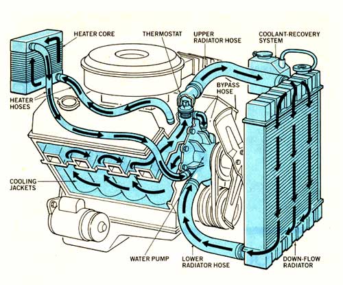

http://www.crankshaftcoalition.com/wiki/images/d/d7/Engine-cooling-system.jpg
