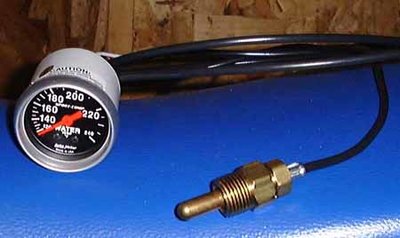

look at the back of the water temp gauge...are there just wires, or does it look like this....if it has a heavy cable coming out the back, it's a manual.
View attachment 9203View attachment 9203

I have a triple gauge cluster under the dash..IIRC they make up to four gauge sets. and you should be able to get just the gauge bracket.

You can always swap the electronic water temp gauge for a mechanical one.
I'd bet the same manufacturer probably make both so you could have a matching set.
I'm running the same as Basketcase, but a different brand.
I prefer mechanical water temp & oil pressure gauges.
