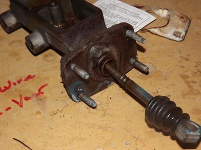

Its been awhile...this afternoon I finally removed my defective/leaking MC. BIG question now is what to do with the original factory studs. Do you attempt to knock them out and reuse? The OEM replacement doesn't have these provisions.
Secondly, what is the procedure for removing the factory push rod link from the old cylinder.

I used the original studs when I replaced mine.
As for the push rod, :huh: I think it just took a little persuasion if I remember correctly.
RR383
Jan 30, 2016
358
Tennessee
So you did drive out the original studs and reused them w/o issue...correct?
I'm going to take a pic of the piston and rod assy.

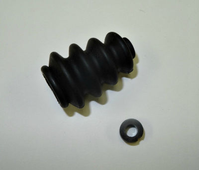

The push rod is just held in there by a rubber ring. There should be a new one with the master cylinder.
You just give it a pull and it will come out, that's assuming you have taken the boot off.
If you can't get it out for some reason, take the screw and retainer off the back of the master cylinder and pull the piston out. It will make a mess.... You have the push rod and piston in your hand now.... Put the piston (it's cast aluminum) in a vise and crack it by squeezing it. The pieces will fall off and you'll have the push rod.
You'll need to put the new rubber ring on and push it into the new master cylinder. I squirt it with a little silicone spray to make it easier.
The ring looks like this:

OK that clears it up...I have all components that you describe. One more thing...regarding the factory studs. Again do I drive them out of the old cylinder and re-use them?
Re-use them.
They should knock out pretty easy.
