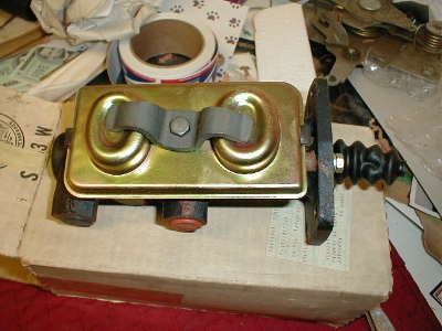

Go to your local NAPA store and buy a new master cylinder. The only visual difference may be the cover. An original style cover should look like this:
If it doesn't and your old one does.... swap the covers.
Bench bleed before installing.
If you really think that MC is the original one (again, I doubt it) , another option is to rebuild the MC that is on the car. It's going to be a little hard to find a good rebuild kit as I don't know if anyone has produced them in a long time. Now you are talking NORS parts that has been sitting around for years and probably dried up. It involves honing the bore etc. and most people aren't familiar with rebuilding master cylinders these days anyway. I don't recommend it, just mentioning it and the downfalls.

Another look shows the one presently on the car has a single bolt holding down the cover vs. the strong back style in pic. BTW, how do you go about determining whether or not this car has the BIG 11" drum brakes...other than pulling a wheel and measuring the diameter? I understand some did have this feature....
81
If the MC in the car does not have that style cover, then it has been replaced. That IS the OE type cover.

I just replaced my MC last year due to some pitting in the cylinder with one from O'Reilly and swapped the original cover as shown above. All I had to do was change the bolt.

I understand...Where does one find the OE style cover...and by all means I plan on inspecting the entire brake system.

You have a pretty good chance that the new MC will have the correct cover. I'd try that first.
From there, you can either find another used cover somewhere.... They used that master cylinder on about a zillion different models. One will pop up. Keep in mind, that's something you can swap any time and it's more important to get brakes working. Or.... If it bothers you $75 worth, buy one of these: http://www.ebay.com/itm/PG-Classic-236-MCC-Mopar-1970-A-B-E-body-Master-Cylinder-Cover-/371533430725?hash=item56811e3fc5:g:H5QAAOSwd4tUKYP-&vxp=mtr

In my case the cover was OEM. I just swapped the original cover to the new MC.
