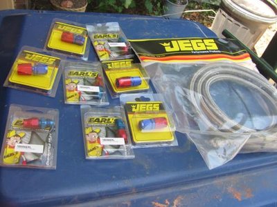

My AN fittings came for the transmission coolant lines. I have been struggling to get them assembled. I know I wasn't an expert at putting these fittings on, but I've probably done around 20 of them before without having much trouble. This time it's been a nightmare. As soon as the stainless braid is cut it frays out away from the hose. I know that this always happens but I've never seen it expand out this much before. I have used Aeroquip and Russel line before without issues. This last hose was sold under the JEGS brand name. I did some checking around with other guys and have been told that the cheaper hoses are something to avoid.

I finally figured out a new trick to assemble these hoses. No matter what I had tried to cut them with, the braid frayed and expanded. Everyone uses tape to try to control this but it wasn't working on this hose. I put a small hose clamp on next to where I needed to cut the hose. Then after using a 3" rotary cut-off wheel, I loosened up the clamp enough to slide it about a quarter inch away from the cut and tightened it up again. I finally was able to get the fittings to go on. It actually was pretty easy then.

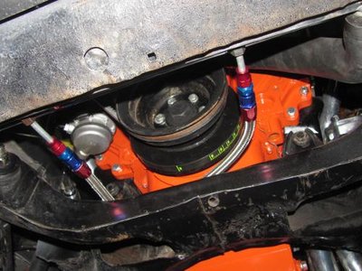

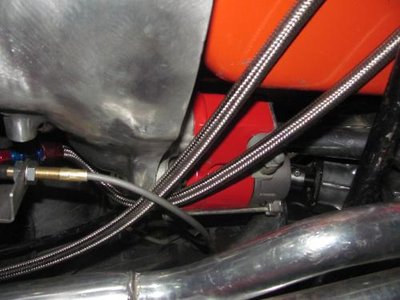

I did get the braided stainless coolant lines finished. I was able to keep things fairly far away from the exhaust. I think I'm around 2 inches away at the closest point. The camera angles make the lines look closer to things than they are.
The new park rod allows the transmission to click firmly into all of the gears (including park) as it should. But now I'm back to the same problem I had earlier with the shifter. It doesn't want to ratchet through 1st, 2nd, and drive. I know that when the cable has no drag on it the shifter will ratchet the way it's supposed to.
I'm hoping to find an adjustment somewhere to fix it. I believe I've already chosen the smoothest route (least bends) for the cable so I'm going to concentrate on the shifter itself. I guess it's time to hit the net for possible answers.

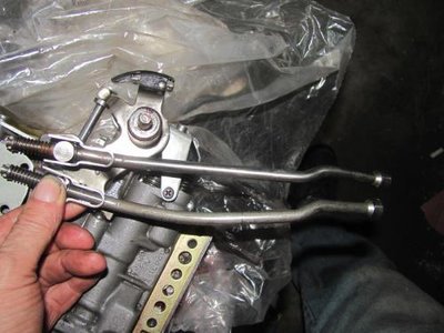

The instructions had called for setting up the shifter while in neutral. Although I followed the instructions carefully, it still wasn't shifting properly.
I had read on another forum to setup my linkage with the car in park. I tried it and it didn't help.
I called the Hurst tech line and was told to adjust the linkage with the transmission and shifter in low gear. They did not think there was an issue with the shifter itself.
Well, the tech line was right. After re-adjusting it with the tranny and shifter both in low, the shifter works fine now.

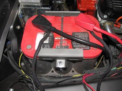

The 'need to do' list is shrinking. I've been going back over the car trying to find any annoying problems that have gone ignored. Although I've had these two interior trim pieces for the rear of the car I never installed them because I could never find clips that would work. I guess I could try to figure out some other way to attach them.
I still need to weld up a battery tie down yet. I should have that done later today.

The good news:
Brake leaks taken care of.
Brakes bled.
Battery tie down bracket fabbed and installed.

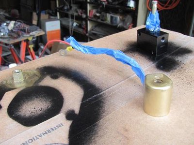

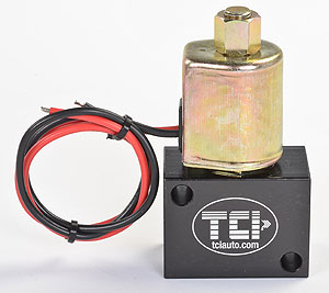

I got to looking through a box of small parts that I'd bought at the Lincoln swap meet earlier this year and I found a TCI line lock. I tested it and the solenoid energizes and it seems to work. (it lists for around $84)

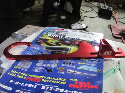

I had paid $5 for the miscellaneous small stuff in the box. I'd seen there was a new billet aluminum throttle linkage bracket (Competition Specialties Inc. $?? - around 50) and a pair of AFCO 2&5/8" quick pins in the box (they list for $10 each) but hadn't noticed the line lock until now.
So I guess I'll be adding a line lock for sure now.

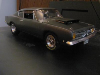

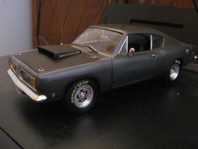

I used to build models when I was young. Naturally they started out pretty crude, but it kept me busy as a kid on the farm. My folks used to get upset with me when I'd spray paint in our basement. I never made a mess but they always thought the furnace would explode.
My brother and I owned an HO scale race track together. I guess cars got into my blood at an early age.
In a way you might say that I never stopped building models but most of the cars I build now are a larger scale.

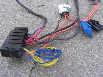

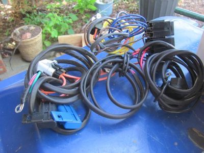

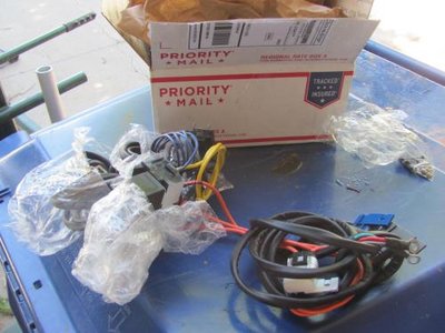

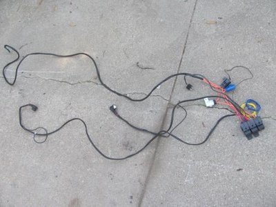

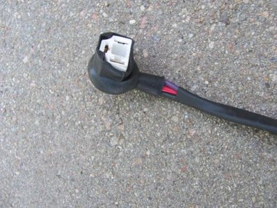

The mailman just dropped off the headlight relay kit from crackedback! Great!! Now I'll have something to keep me busy while I'm waiting for that drive shaft. Everything is really starting to come together on this project now.

Everything looks good so far. I've only glanced at the instructions so far but they looked to be pretty thorough. I should probably change my name to Murphy though because if anything can go wrong it usually does.

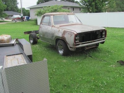

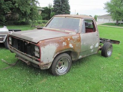

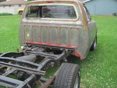

4) I wanted to get the Lil Red Express moved into the garage in town. (AAAAGH!!! I always knew I wasn't the sharpest knife in the drawer but today I think maybe I'm a spoon.)

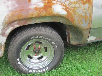

I went out to the farm with my son and moved all of the parts and household items surrounding it out of the way so we could roll the truck out. Without a carb or battery I had planned on trailering it the 5 miles back to town. The brakes were dragging on the truck bad enough at first that I got stuck on the first few attempts to pull the Red with my Ford across the yard to where the trailer was. Eventually they freed up and everything seemed fine. That's when it occurred to me that I might as well use the tow rope to get Red to town instead of the trailer. That way I wouldn't have to use a come-along to load it.
With my son steering Red I drove the tow vehicle. We made it about a quarter mile before the left front wheel came off. I had forgotten that the scab tires/wheels that I'd put on the Lil Red were an odd (and incorrect) bolt pattern. The lugs couldn't be tightened up. When the wheel came off it smashed the left front fender (and inner fender) behind the wheel well. Doh!
We pulled the truck off to the side of the road and went and got the chrome slots that were original to the Lil Red. After replacing all 4, we started back down the road. The right front brake caliper was dragging and kept locking up every 100 yards or so. We made it back to town but it took a long time. For now, I've got it parked on the lot behind my house.

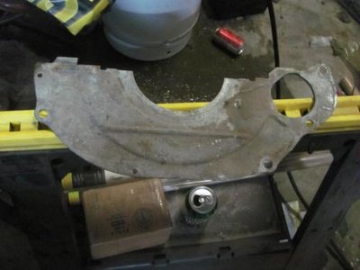

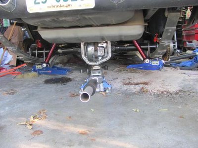

Well, I've been cleaning up the dust cover and the line lock in preparation to put them on. I'm not looking forward to having to drop that starter again. Headers make everything so much fun. - At least I'm running a mini starter. While the paint dries I'll run back to the parts store for some flare fittings to use on the line lock and some bolts for the dust shield.
I need to get started on the headlight relays too.

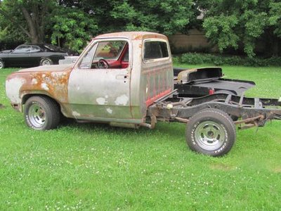

I know that the damage to the Lil Red isn't super serious but it's still a set back. I only have a narrow window of time to get it ready for paint. Knocking off the surface rust that had formed since it sat, going through the brakes, replacing the fuel pump, and rebuilding the carb have all become priorities. I wasn't planning on the fender.

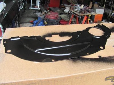

SONUVA... The dust shield that I picked up at the swap meet is not for a 727. It's for a 904. After dropping the starter that is not what I wanted to find out.
