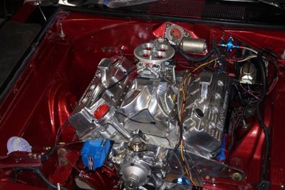

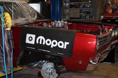

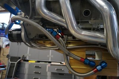

hemi"s in.....need to finish her up.....hood will not work ....need to order a 5 inch tall 6 pack bolt on fiberglass hood
1967 'cuda
Mar 6, 2014
794
David City, Nebraska

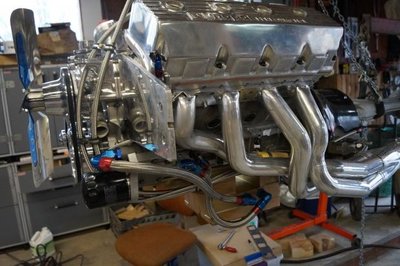

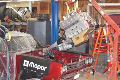

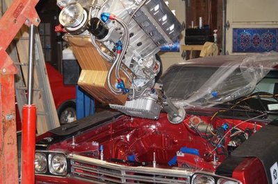

so getting stuff done.....cleaned up 727...changed filter....and started putting her together....tranny/convertor bolted up ..before i bolted up tranny i was looking at the date on my CSR Transmission/Flexplate Super Shield ....bought it new in 2004...well guess what....they need to be re- certified every 5 years.and to buy new they are on 6-8 weeks back ordered....so screw it.....had to ball peen headers.....was hitting on side main bolts.....oil gallery plug need some grinding for clearancing starter.....have to add indy 3/8 inch spacers behind water pump to align pulley"s then align alternator ...would rather mock all this up before i drop it in.....i hate surprises
