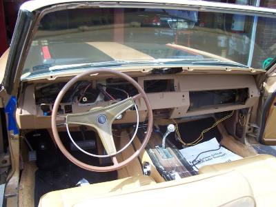

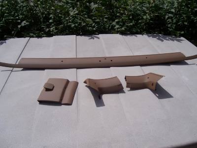

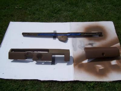

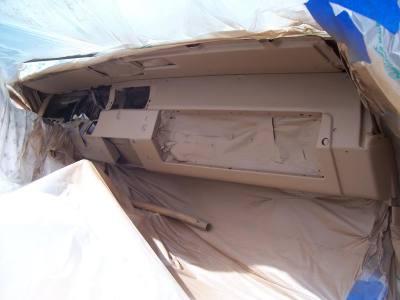

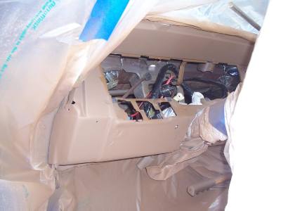

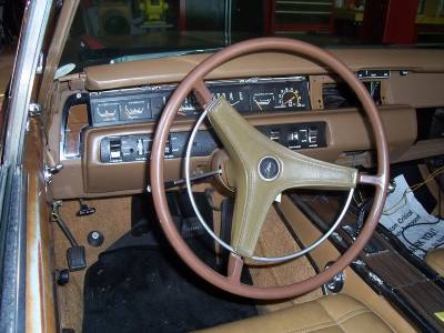

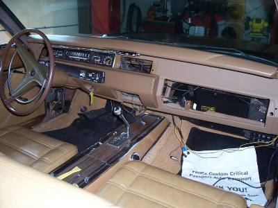

Steel dash all repainted where the incorrect "Dukes of Hazzard" tan was:
Masking removed:
Metal trim painted and ready to be installed:
Dash pads dyed back to the correct color (dead on match too!):
Reassembly starting!

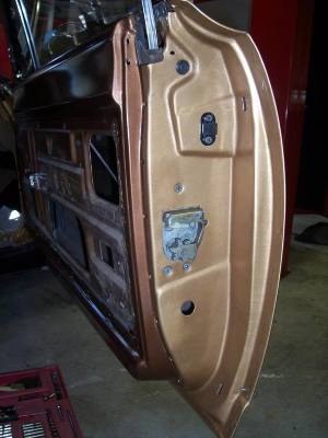

102_5932.jpg pass side inner door frame and door jambs repainted!

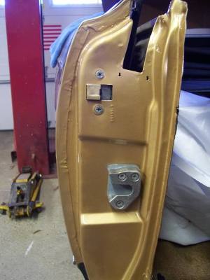

102_5933.jpg latch reinstalled and cleaned up

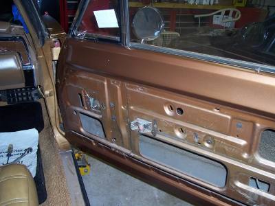

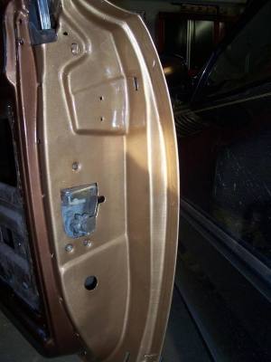

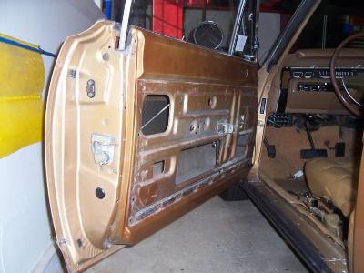

102_5936.jpg driver side inner door, inner door frame color painted first, then masked off and exterior color applied.

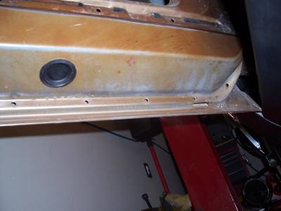

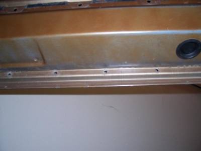

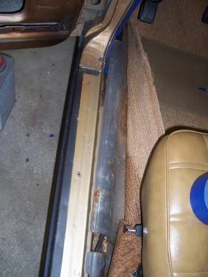

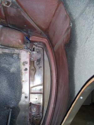

102_5934.jpg driver side prior to disassembly of all the small stuff. notice the lower left corner of the door where they must have had masking still on the corner of the door. interior color showing where exterior color should be!
102_5935.jpg again, notice the masking pattern!

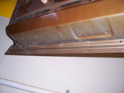

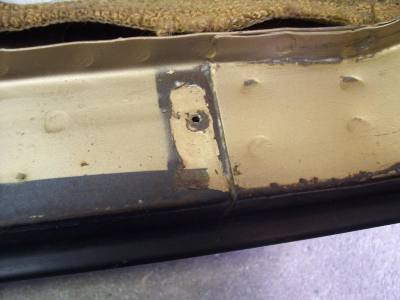

102_5938.jpg underside of the driver side door. notice the lack of paint that was applied at the factory!

102_5939.jpg another pic of the underside of the driver side door and lack of exterior paint!

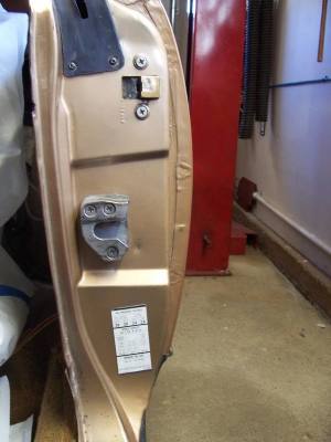

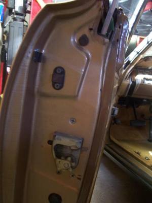

102_5945.jpg driver side door jamb prior to disassembly, original factory tire pressure decal!

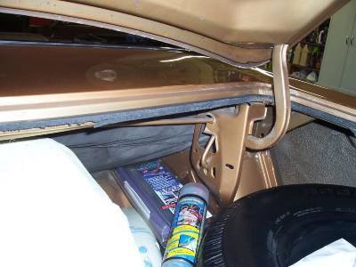

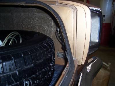

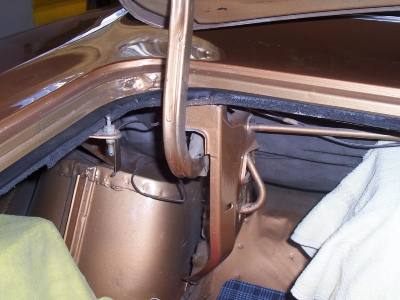

Some of you may have seen my post about wanting NOS trunk weather stripping. Here is why.....Debating on whether or not to replace the trunk weather stripping. Its the factory installed original but as you can see, it is starting to dry out and show its age. If anyone has any leads on an NOS one or an mint used one, please contact me! I'd hate to have the trunk seal be the only non-original weather stripping on this car.
102_5947.jpg original trunk seal showing its age!

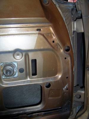

102_5946.jpg more of the driver side door hardware.

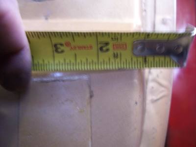

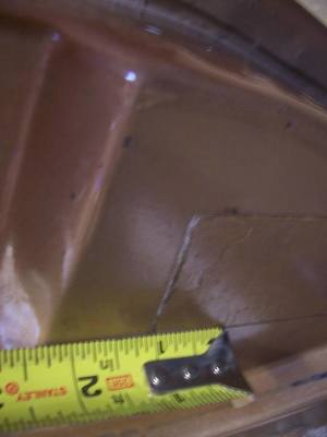

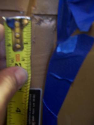

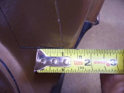

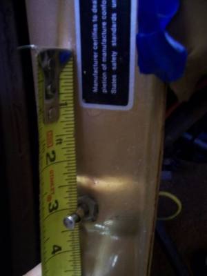

102_5960.jpg measuring of where original tire pres. decal was for replacement later.

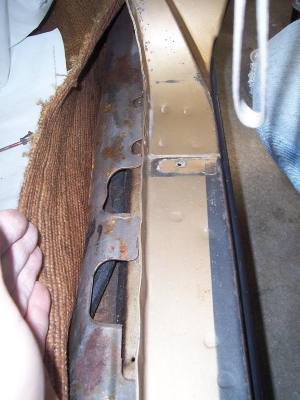

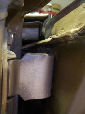

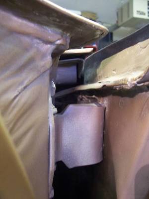

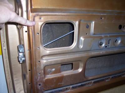

102_5964.jpg piece of cardboard wedged or installed between the upper door hinge and the cowl :clueless:

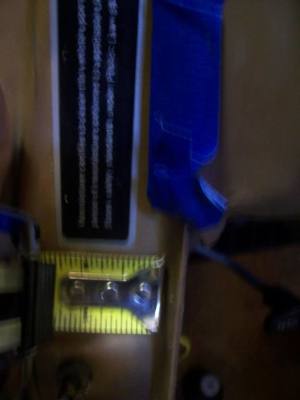

102_5965.jpg more measuring of where the original decals were!

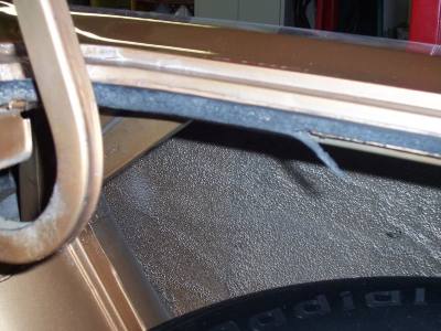

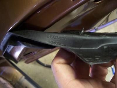

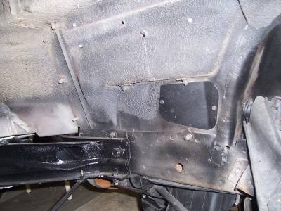

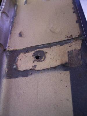

102_5972.jpg removed the splash shield which was coated in factory undercoating in which we had to scrape it away to get the bolt heads exposed enough to remove them. notice the red oxide primer! Also, we found a piece of bail wire hanging from the mounting bracket hole on the cowl where the bolt "should" (key word!) have been. Apparently, our car had a factory mess up as there was no bolt ever installed nor any shims. Would anyone know what this bolt size was off the top of their head? Worse comes to worse, I can always pull out the one on the pass. side.

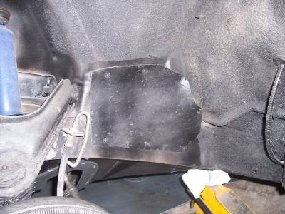

102_5973.jpg driver side wheel well with original factory applied undercoating.
102_5974.jpg (forgive the bumper brackets, Dad tried to repaint them to save me some time. We'll correct that when we pull the bumper back off to do the rad support black out.

82
what is this for?
My 300 vert has that too. I assumed it was a C-Body thing, but now I wonder if all the verts had them.
They have to be either so the door doesn't slam or to keep the door tight against the latch. You have a lot more body flex in a convertible.
