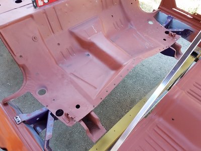

I had to use the rear frame from one of the coronets in the roadrunner and so far, from test fitting, it is all the right length. I had placed the front of the frame assembly in the right spot on the rockers, then put the quarter panel in place against it. The quarter panel fit perfectly:). So, I just know, that the parts I used out of the Coronet (rear frame, under seat floor pan, roof pieces, cowl patches, door hinge mounting area) all are exactly the same as the runner's. What year Coronet did it come out of? 68-70 are all identical, but before that, only the front floor pan is the same and possibly a few other things.
That is the way you have to do it. My quarter from AMD is not fitting so well but like all the rest of the after market parts will have to tweak it a little here and their. Will make it work. Putting on Lock pillar next then working on the tail light bucket and that area along with putting on the outer wheel tub. Ho what fun it is. But at least I am at the rear of the car. Russ. :steering:

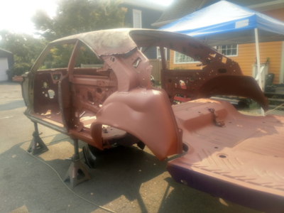

It is pretty cool to still be able to see where they dipped the cars. This car, when I got it, had very little rust and things like this wheel housing didn't have all the surface rust. but after sitting a while exposed to salty air, it rots away quickly. It still has lots of the factory chalk markings too. I need to document them before they disappear for good.

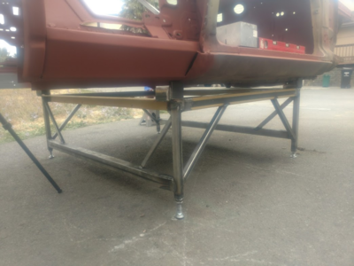

I have an update on the car's progress as well. The red primer was finished being sprayed over the back of the car and the interior. And, with help from my dad, I got a leveling jig welded up so that I can marry the two halves together easier and more correctly. I made the leveling jig out of some scrapes I picked up at a local metal yard, some carriage bolts w/ matching nuts welded to frame legs, and a 10ft (I believe) Powermatic table saw fence extension. Yeah, I know that sounds weird, but we don't have a Powermatic table saw and it has been sitting around in the garage gathering dust and occasionally falling and hitting people in the head. I think my dad enjoyed cutting it into pieces:D. Revenge is sweet, and can make a sweet cart!
Now that the car is all level, I need to make a small jig to level out the rear assembly. Then, they can come together for good, and some large steps will be made in this build.

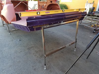

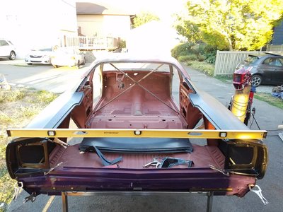

Today I had to finish getting the car and rear assembly level, so another jig was needed. But, I didn't get to it until 3:00 because of high school orientations:mad:. Crazy schools take as much summer as possible away. I am a sophomore now. Anyways, I used the bumper bracket bolt holes to mount a jig to the back of the rear assembly allowing me to level it to the car. The front of the rear assemble just rests in place on top of the rocker panels.
After finishing leveling everything out, I just could not resist mocking everything up. Damn it looks good (the car I mean).

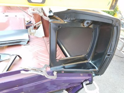

When test fitting them, it was found that there were issues with the tail panel. When putting the taillight buckets in, the driver's side would not fit. That is when I was thinking "Oh F*%$. What is wrong?" I was worried the quarter panel was made incorrect, which was made by golden star (were really cheap!), not amd (too expensive for me). It turned out though that the source of this cataclysmic failure, was the AMD tail panel! It was the only AMD part I bought in the first place because golden star didn't make it, and it just so happens that it is the one that was ridiculously off. On the side that fit correctly, the overall height measured 5 5/8 in, and on the faulty side, it measured 6 in. This meant I had to cut a whole 3/8 off one side to get everything to fit. And there were other flaws too on the panel like all the center lines not lining up on center! There are three distinct center lines on the tail panel. One at the rolled over edge at the top, one on the body line that runs across, and one that is an indent in a body line where the license plate light wire would run down to the bumper. None of those line up. Might have to try and fix them with bondo to line them all up. Other than the tail panel, everything lines up really well around the wheel wheels and in the back corners.

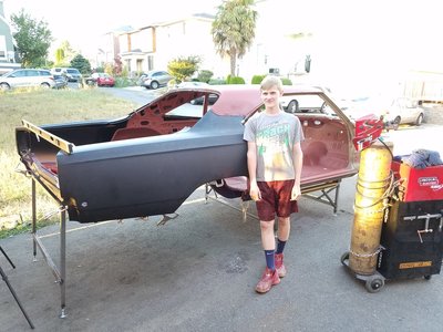

Can't help but ask. Are you doing this is a apartment complex or gated community. Can't help but look at backgrounds of pictures. It's a disease.
Yea my quarter had issues where joined the back window. Where the corner filler is and the out side window frame metal. Had to get a hammer and some flat bar and reformer the edge. It was too long at very back and the same with the tab at the corner filler. It was sitting higher that the filler panel gutter edge. Also set to high off the tail light so it did not want to line up even under the rocker. But got it now and always think the problem through. Your car is looking good and see the progress you have made. Well got to run Russ.
Yeah, no. I live in a culdisack that use to be all one plot of land. The house I live in is the original 1907 farm house. All the other houses kind of look like small apartment buildings(they aren't pretty). Our garage is full of tools so I have to work in the driveway.
At least you have the drive way. Have worked out on the dirt before and it is no fun. But a man has to do what ever it takes. Looking Good. Russ. :thumbsup:
