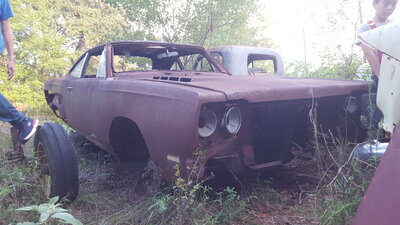

Well as some of you know I found what looks like a dead 69 Roadrunner but turns out to be a preaty solid car. Only crossmember that needs work is the shock crossmember. Yes there is rust that needs work but we are already on our way. We verified vin#'s as the lynch road fender tag did not match. The radiator core support and dash tag match, next it is a post car and the fender tag was for a non post.

That sounds grate Stephen. Yep get the boy's involved. It will be a learning curve for them and you. Good to see your going to bring it back to life. Found mine and it did get pretty deep on the metal work. Every thing is out their for these car's. Only thing is inner frame rails have to be gotten from other donor cars. Will be watching for your progress. Sound's like a plan. :thumbsup2:

Looking at the quarter panel it looks like someone lost interest in the project some time back. Bench seats are hard to find so don't toss the old one yet, it might value .
Car comes with new quarters. Passenger side drop off is good but driver needs replacement or patch at the bottom. The seat has one of the split backs mia and the lower section is pretty bad but we will see.
