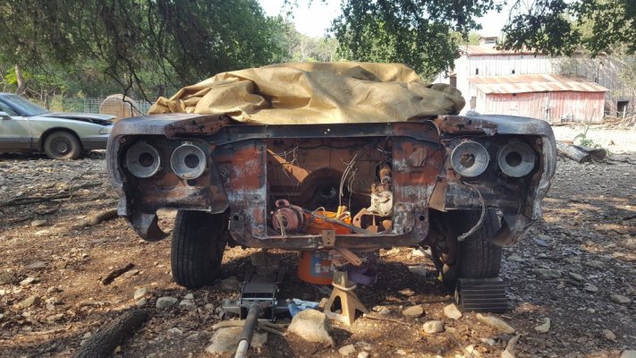

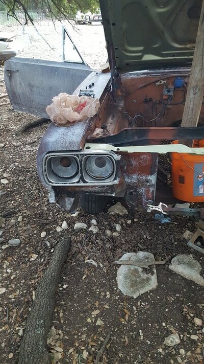

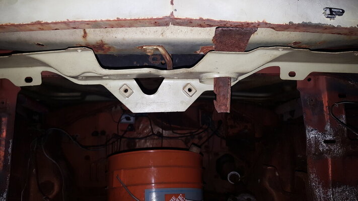

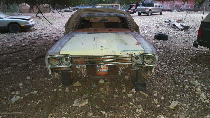

Ran out of daylight where I was working last night. Managed to tackthe radiator core support back together. Will weld it up and reinforce the lower portion.Screenshot_20210831-013311.jpg

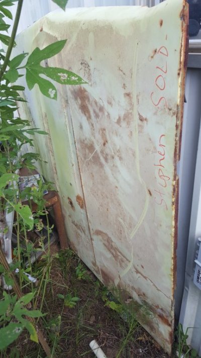

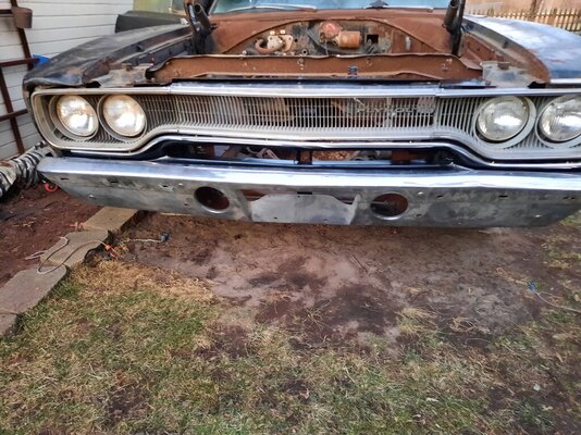

Had a successful trip to John's Salvage. Not a RR hood but got a 68-69 belveder/satelite hood for $175.00 + tax.20210910_165508.jpg
Also got fuel filler neck $25.00, inside door handle $2.50 & working 2 door window regulator $45.00.

Did you check your hood yet for fitment. Early 69 takes a 68 hood. Latter 69 is a different hood. The hood latch bar is in a different place and the hood safety latch is the same way. The one thing you would have to get from a junk yard may be the door latch and handle mech. Filler necks are new for sale. So are door handles. Classic sell new window regulator's. So are you doing a total restore or just trying to get it into a driver.
Initial is driver. Will be shooting expoy primer in the hidden areas as we put her back together. The hood is a make due unit till we get to where the right parts start mattering.

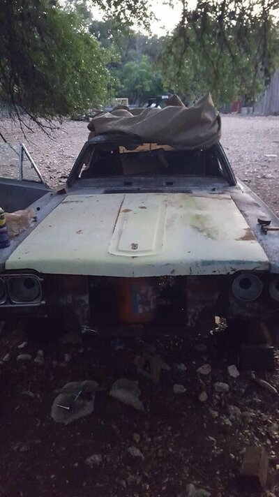

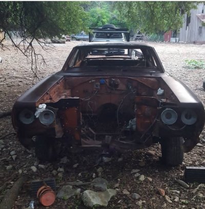

Got crossbar, hinges, hood and the one headlight bezel in yesterday. I need to start on the patches for the floor pan now.

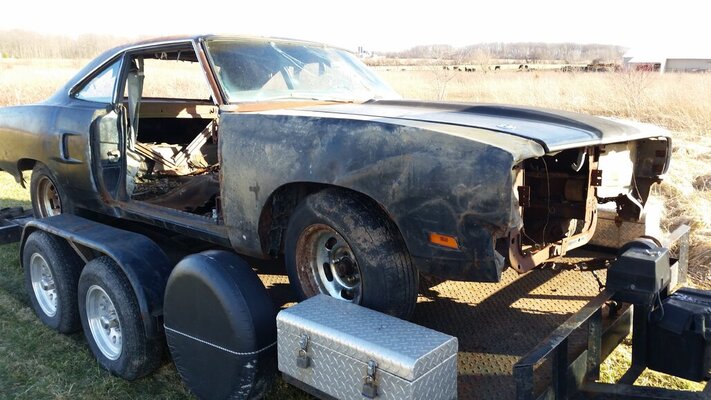

Ok a start of the updates. Due to work I havnt been able to do much over the last 2 months, ( I got home this morning at 1:15 am from 8 weeks on a boat in Mexico). The good news is that
1. I now have the bond for the Bonded title and everything will be finally filed tomorrow with the title in the mail this week,
2. I was able to get my 1/2" bead dies for my beadroller for trunk and floor pan patches,
3. Time to work on it.
