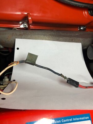

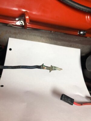

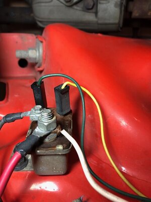

No more click? Nothing now? I recently bought a '71 rr 4 speed that would intermediately not start - cold or hot - NO CLICK - NOTHING, then it would suddenly start (scary but never left me stranded). It is either the clutch interlock switch (under the dash attached to the pedal linkage) or in my case the connector from the fusible link was toast (see pics). I replaced the spade connector on the fusible link wire and put a terminal lug on the starter relay (both properly crimped) and problem solved! Mine was just dead when I turned the key - no click...

I was just about to suggest the fusible link. My first 69 had an issue just like this and then it let go. Check it out.
