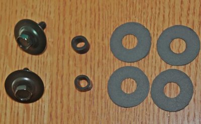

Quarter glass mounting hardware
When you do the back ones be sure you use the glass washers. They are a black plastic or make some with thin gasket material (not as weather proof) and small rubber spacers that fit in the glass hole. You run the risk of the glass shattering should you not use them. I am in the process of trying to reproduce ones from a more correct material. Good Luck
