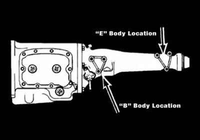

I would try to find the correct trans. This would make it easy to in stall. This car had a automatic put in it and it was original four speed car. Only thing I had to do was cut the mount off the transmission support and open a hole in the middle for the rubber mount to slip into the cross member. All the holes where their to do that. Just my two cent's. Don't know if the A body transmission will work. The shifter might bolt up different on it. Ours mount to the rear near the tail shaft. Check with brewer's for the correct one. Or maybe Tony's might have it. Got mine out of Co. from a guy off E bay. Luck would have it was all like new in side even new shift fork's. So good luck and try to stay with original part's.

Unless I'm mistaken, the B body shifter mounts in the location closest to the side cover and the E body mounts in the rear position. It really depends on the year, There is actually a set of rods for 71-74 B body with a bench seat. A bodies are a different animal, it depends on slant 6 or V8. Go figure. I would call Brewers before ordering.
