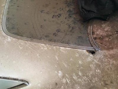

these things like to rot at the bottom of the back window, which leads to trunk floor rot. the floorboards, usually the drivers side the worst. mice love to build nests inside the frames, as well as being a catch all for dirt, sand,etc, so check all the frames for rot.there are a lot of repo parts avalible for the mopars these days, just depends on how big your check book is.

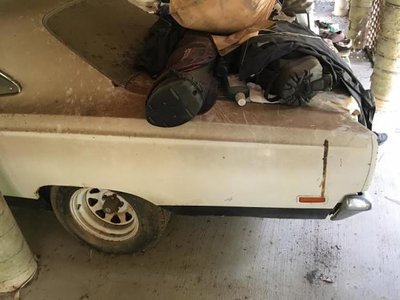

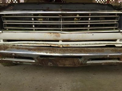

other extras this car will probably need are a new fuel tank and lines. existing probably full of corrosion, looks like right side rear quarter panel, check trunk extensions behind quarter panels, look hard at frame rails, as basket said, trunk floor. check trunk lid carefully. this is one piece not currently reproduced, hopefully that was hood behind it.

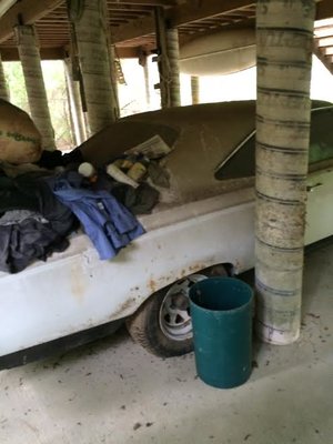

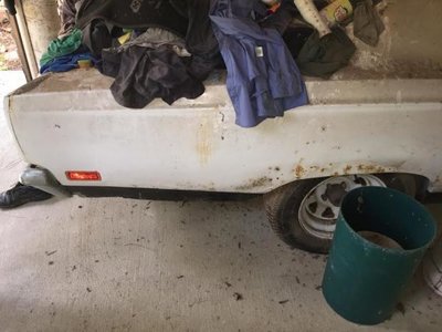

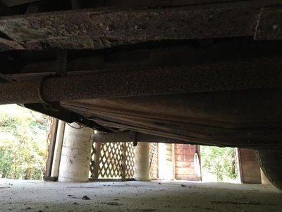

Here are more pics... the undercarriage of the car seems FAIRLY rust free. I know these pics suck but I didnt see anything that looked rotten. Everything has surface rust but didnt look to be destroyed or even have any rust pits in it.

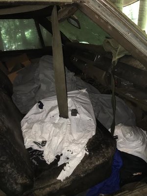

All interior is present... hes got his shit everywhere. lol I didnt want to be THAT intrusive to remove it all but I definitely will before I buy it lol.

looks fairly complete. I'd say by your pics plan on a pair of quarter skins, maybe a trunk floor. how do the floors look?

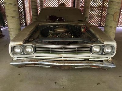

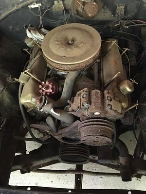

looks like the steering box and part of the column is missing, along with the radiator and exhaust manifolds.are these (and any other MIA parts present, and whey were they taken off? what engine is that? free or stuck? auto or four speed?
I'd say $2500-$3500 as it sits.

The guy swears up and down its a running motor... said it hasnt been very long since he last started it, but hes missing the wiring harness lol so I am skeptical. It is a 4 speed.
I got on my back and looked underneath.. its seems in very good shape.
The motor is a 383. I plan to get it out from under the house and get the trunk open, clean it up a bit and have a better idea of what I am working with.
well I'd base any offer on the motor not running until he has it going in front of you.

Without looking in the trunk it is a crap shoot but as high on the rear window that the rust hole is I'm going to guess you are going well over 7000 on body and paint unless you do the work.
