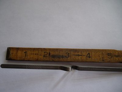

Still tackling my fluid 'blowout' during cold starts after the car is parked overnight.
Attached is a picture of my transmission dipstick.
Can anyone, who owns a GIRLIE 727, tell me where on the scale does the FLUID rest on your transmission dipstick. The reading to be taken COLD, not running, and after your car has been parked for a few days.
I'm trying to take the various readings on my tranny to determine how much 'T/C drain back' I'm getting and compare it how much is tolerable.
Thank you in advance,
