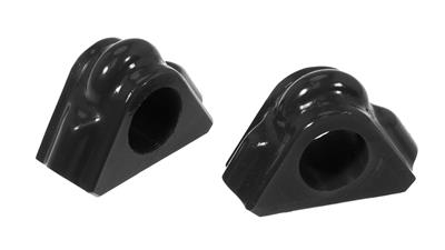

Revving this thread from the past...
I may have missed it, but where can I find the correct sway bar to k-frame bracket bushings for my 69 Road Runner? Are there OE or NOS rubber type bushings or are the poly bushings the only ones available?
Just looking for a correct OE appearance. What's everybody doing for this?
Thanks!

It's been a while since I looked at my originals, I believe they are in pretty good shape so I'm not sure if I should worry about replacing them or not. I also thought I saw some NOS ones on eBay or somewhere but can't remember for sure. I did look at PST and Just Suspension and nothing other than aftermarket straps and bushings. I went to my Chrysler Master Parts catalog and found the sway bar assembly but nothing shows up for the bushings; perhaps they weren't an intended serviceable item?
Then at good old RockAuto I found these: RAYBESTOS Part # 5501102

I searched long and hard and found nothing but poly, that was almost 3yrs ago but I haven't heard of any rubber ones being made. Any one else :popcorn:

The ones you need are triangle shaped
So someone made poly bushings that replace the OEMs? What color are they; Bright RED, YELLOW, BLUE or simply Black?
Back to the Raybestos bushing. Are the originals formed to fill in the bracket space or round as shown in the picture? Is the one shown a universal type of bushing? Has anyone ever actually seen a NOS bushing? If they ever existed, what do they look like, and what is the part number?
Thanks!
EDIT: Okay, thanks 69hemibeep... Raybestos out...
Thanks!
The poly ones are black that I got. Do you need a source?
Yes please! I'd like to check out the source of the poly bushings. Do they make any noise that you've noticed?
Thanks!
They are quiet, I have to go back to work so I may have to post the source later its in my recipe book which is rather thick :lol:

Are these it... http://www.ebay.com/itm/MOPAR-B-Bod...|Model:Roadrunner&hash=item3cc06deae1&vxp=mtr
CompSyn
Jun 18, 2010
255
42
Lewiston, Idaho USA
Great! After a little more digging I found the same part at Summit Racing for only $10.75.
According to my info, the factory sway bar on my 69 Road Runner is 0.94" otherwise 15/16"
Summit Racing Part Number: PTP-4-1105-BL - link
Cool! Learn something new every day! I'm going to pick up this set next Summit order.

Just make sure to put LOTS of silicon grease on them or they certainly will squeek and creak!
