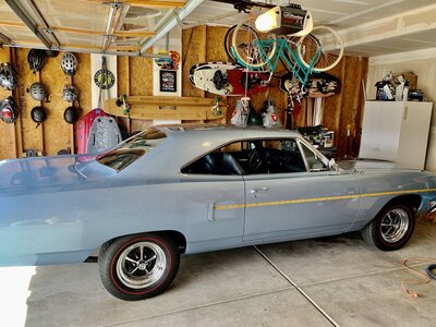

Yes all new fuel lines, electric external and in-line Mallory comp pump, don’t know about the sending unit I’ll review. Car was given to us by my father-in-law, under his care for about 7 years of which the last 4 it was being redone.

Really a rad car. Well maybe just trying to figure out what it could be. So if all that was done then it is under the hood. I would say. I know it can be frustrating trying to figure out what it could be. It is something simple that is being over looked. A heat shield would be a simple fix. Do you have one of those temp readers that is hand held. Might try looking at the carb bowl's. Check temp cold and run the car around the block the take another reading. Dose the carb have filter's built in like Holley has. Those are small and have pulled them out before. What grade fuel are you running.
