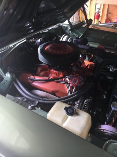

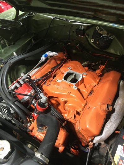

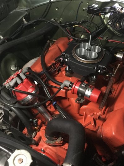

Got some more time tis last week and got some good time in and installed the Holley sniper, with in tank pump. Didn’t wire it for timing control yet. But what a difference. Starting is awesome, so far it’s very good update. Didn’t get to drive it much because of the weather but performance is way better.

Update on the sniper, set the base timing on it with a good buddy and a good timing light. 15 at idle and 38 at 3k. put about 30 miles on it and no issues at all.
