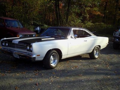

here's a white one that belongs to the buddy that;s painting mine.

That is sweet, black vinyl top, nice. So after seeing this beauty are you going to change paint color idea.
If he doesn't I might! It's hard to beat a white car with black top. I still haven't decided what color mine will be. The problem is these cars just look so damn good in every color.:beep:
