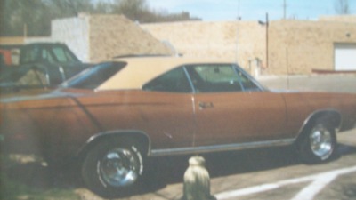

in the pic i found is the same as what you show for a rocker molding.
So is it safe to say these moldings may be Sport Satellite only? I have looked at at of pictures and so far that is all I see them on. :cool:
yes to satellite only.[figures]

Cool picture. Keep me posted if you get something to work. I sure like those moldings better.

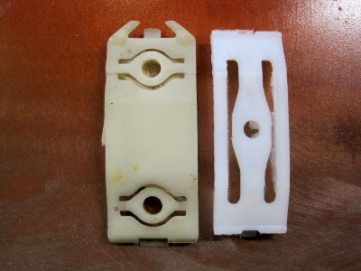

Recently removed a pair of Rocker moldings from my Sport Satellite to use on my Road Runner. I then ordered all new clips on ebay for it. When they showed the clips are about 1/8" smaller so they won't work. Anyone know if there are two sizes in 1969? Here is a picture of the two sizes I found.
The one on the left is the original with two holes, and the right the "Authentic Mopar" repop

In short, my 69 RR has 1 hole in the center of the rocker, not 2.
Yes the other B body Plymouths apparently used the single hole type that everyone sells. Nobody sells the two hole type since it only fits one car. So far the only people who even know there are two types are those who have read this thread. The rest of the Mopar world just thinks I am crazy! lol

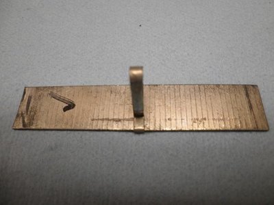

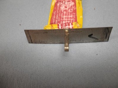

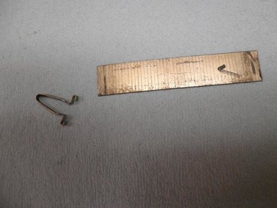

Back in 1992 I needed some clips for my rocker molding. I had a few including the metal clip that went on the ends to keep them aligned. A local paint & body supply store had these galvanized clips that slid under the lip. They are segmented at 1/16" and are 5/8" wide and came with clips that retained the molding to the body. If you have a few of the originals these may be an option for some of the missing ones.

Looks like those would work. I am still on the fence with them, but may have to make some. :brickwall:
