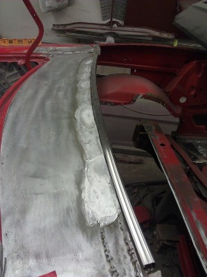

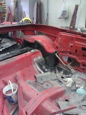

Been there....done that. You can modify the AMD inner wheel house to work. I would also use a full quarter. Graft it in at the deck-filler panel.
My car is the poster child for AMD. If they made it, I bought it! Can't go wrong with AMD. I just wish they made a deck lid for a 69.

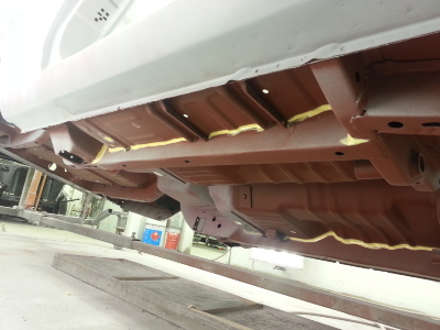

US Car tool makes a good set of frame rail connectors that are a must for a convertible. Also, they make the torque boxes you'll probably need.

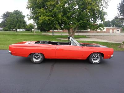

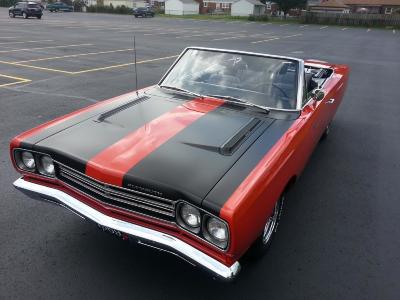

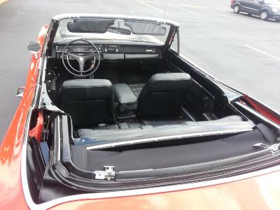

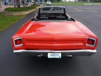

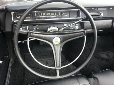

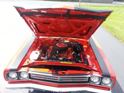

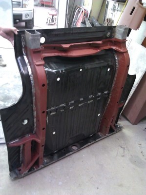

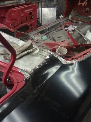

Here are a bunch of pics from my convertible restoration...

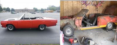

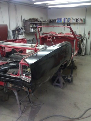

Here's my before and after...

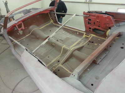

Brace it right if you use a rotisserie...

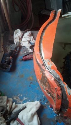

One piece install on the trunk...
Go with the full quarter from AMD...

Man that's sweet Chappy.
Where did you get those floor mats if you don't mind?
Dante DiCarlo (Dante's Mopar Parts) has them for about $120 if I recall correctly. They're heavy duty, with spikes on the front set to keep them down. The rear set slides around a bit, but they look nice too.
Wow yes very nice! I will do that with the trunk install for sure! I was gonna use our rotisserie but i was worried about bracing. Anyway my father is stealing it for his 70 mach1. Doh!

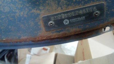

There were no 440 Roadrunner convertibles in 69.
They were all 383's with the exception of the 10 Hemi cars.
R = Plymouth intermediate chassis (Satellite/RR/GTX/Belvedere)
M = middle price range (Satellite/RR)
2 = 2-door
7 = Convertible
H = 335-horse 383
9 = 1969
G = St. Louis
Sequence #: 246006 = 146005th Vehicle

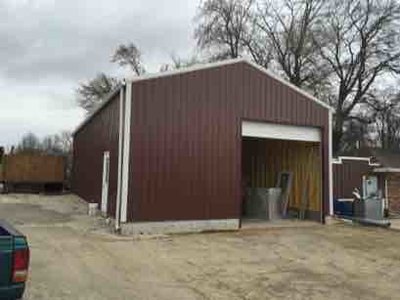

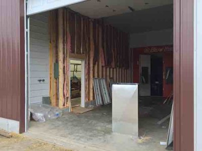

Well I have been slowly working on the convertible but been trying to finish a more important task at hand. ImageUploadedByTapatalk1428030280.104571.jpgImageUploadedByTapatalk1428030295.983800.jpgImageUploadedByTapatalk1428030309.841312.jpg

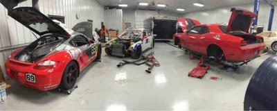

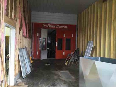

We had a fire in October and are finally getting our paint shop finished and it's bigger and better.
