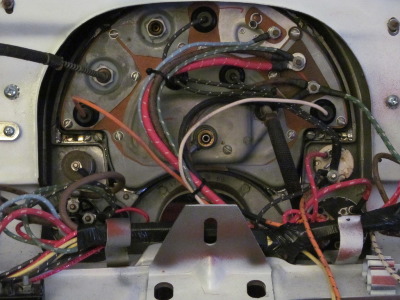

Hi guys. Been a long time. Reading the posts on wiring replacement seems like you do not replace wiring/harness's with after market kits. I have all my wiring out of my 68 bird. I do not see where wires are broken but I did have a terminal fall off. Is this an issue I need to address? I looked at a wiring kit from American Auto Wire (ouch $$$) also worried about fitting to car. Thanks BIG JOHN for the idea of putting the dash on a stand. Any help from you guys will be appreciated, thanks Big Mo.
