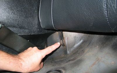

i would like to know more about the rear seat mounting, mine seems to be missing something and comes lose all the time, right now the only attachments I can see or know of ar the two hooks on the rear wall to trunk, is there something at the bottom near the seat belt bolts? Pics?

If it's the back, there are two bolts at the bottom where those u shaped wire hang out of the upholstery. Will take pic tomorrow for you

If we are talking about the seat back, mine simply had a tab that bends over the U shaped steel rod.
Just bend this tab to hold it in place.
well that's good to hear because it looks like nail polish and not dirt....:jester:
