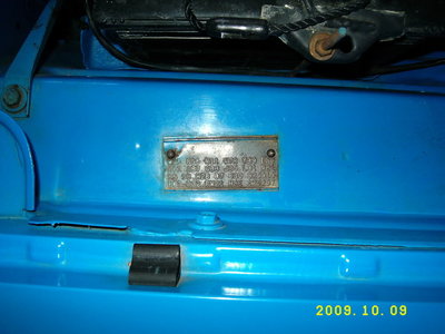

well it is a 99 99 paint code car very rare . I have only seen the ralley green / or omaha orange cars ? you might keep digging to see if you can find sign of the orginal color ? but with a b 7 interior you may really have a 69 petty blue car ?

:banana: Thanks mate and what is a B 7 interior ?

A dark blue interior or I think in this case the upper door frame color;
B3 = light blue
B5 = medium blue
B7 = dark blue
Man, there's a pretty darn good chance that is an original "Petty Blue" car :thumbsup: :thumbsup: :thumbsup:

take a pek under the carpet, and in the trunk.

the whole trunk is blue,i also checked under the dash and its red oxide with some blue overspray i havnt got to pulling the seats apart to find broadcast sheet .
cheers

Here's the whole thing broken down for you to the best of my knowledge:
RM21:
Plymouth Belvedere,Satellite
Medium, Road Runner
2 Door Coupe
H9E: 383 330HP OR 335HP 1-4BBL 8 CYL
1969
Los Angeles, CA, USA
125297: Sequence number
E63: 383 cid 4 barrel V8 H.P. 335hp
D32: Heavy Duty Automatic Transmission
99: Body paint code - Special Order Exterior Color (probably Petty Blue as previously noted)
99: Roof/Vinyl Roof Color - Special Order Exterior Color
H2B: Trim - High, Vinyl Bench Seat, Blue
B7: Int. Door Frames - Jamaica Blue Poly
B30: Build Date: November 30
925910: Order number
A01: Light Package
A87: Road Runner Decor Package
G33: LH Remote Mirror
J25: 3 Speed Wipers
L31: Hood/Fender Mounted Turn Signals
M21: Roof drip rail moldings
M25: Wide sill moldings
N96: Fresh Air Hood
R11: Radio Solid State AM (2 Watts)
V7R: Accent Stripes, Red
Y39: Special Order
END: End of Sales Codes

All off the top of his head :basketcase:

You guys are awsom thanks for the help,i just got back from the panel shop and the bloke there was foaming at the mouth he recons the car is mint just the small rust spots and he wants to soda blast her :eek: i near shit when he told me that but as he said the paint will be like factory when hes finnished im off to open a bottle of Uncle Jack and think about that one thanks again ACME :thumbsup: :cheers:

The switch was announced on November 26th and this car was built on the 30th. It's entirely plausible that this car was ordered before that announcement. Have any other Petty Blue 1969 RR's surfaced since this guy asked these questions? Basketcase, did you ever find that story on them?
