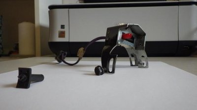

So glad you asked...
Here is a pic of the plastic lever and the backup lamp switch it actuated: IMGP0249.jpg

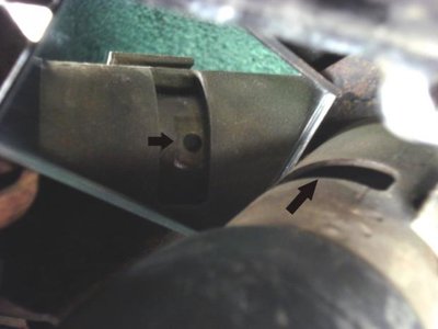

These pictures are from the thread on another forum: 5400562-DSC09277rss.jpg - this what the plastic lever fell out of.

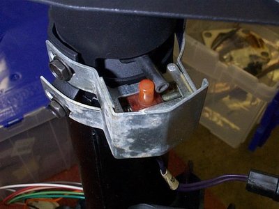

This is the switch from the other guys 1969 383 roadrunner: 5400563-DSC09286rs.jpg

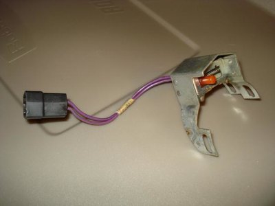

and this is what the assembly looks like with the column out of the car: 5402450-newcolumn1.jpg

I posted some pictures of what I'm dealing with (as per A31PKG request) so that you all could see what I'm talking about. The picture in my "so glad you asked" post are the parts I pulled from my car- my steering column is still in place. I only wish I had that new assembly on my shelf!
I am still working on adapting an operating lever (made of metal) and hopefully I'll never have to deal with this problem again. It's got to be better than plastic...
