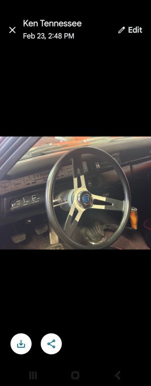

Thank you again. I just picked this car up in Tennessee and going through it. The speedometer is at 100 and bounces the previous owner put a new speedometer cable on it didn't change. He put a new dash in same style as the original but white. He said it did work but started acting up. You have any ideas?
