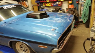

My super shaker project for my Challenger
6PKRTSE
Oct 1, 2018
291
328
Motor City

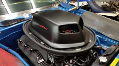

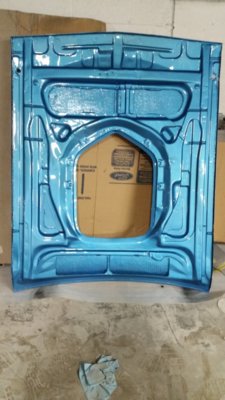

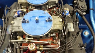

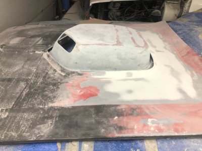

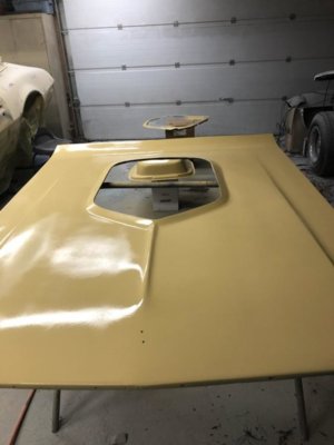

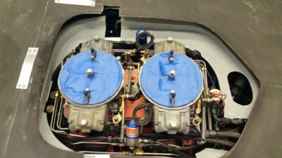

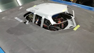

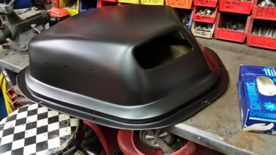

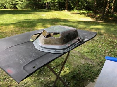

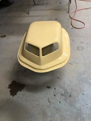

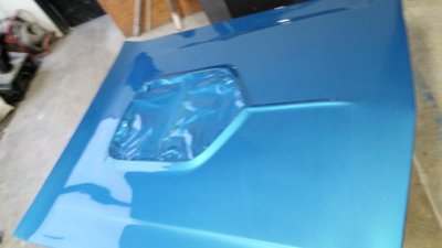

Needed to come up with something to clear the tunnel ram on dual dominator's. Decided to go with a modified super shaker. I stretched the hood opening 3" longer, the base and bubble 3" also, the bubble 4-1/2" taller and opened up the nostrils 2-1/2" taller.

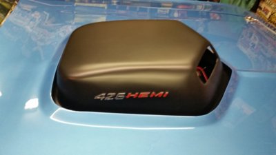

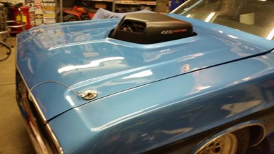

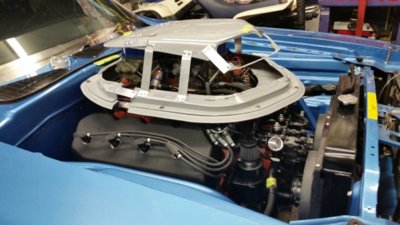

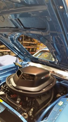

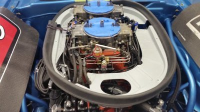

Mounted everything up tonight. Hood still needs some final adjusting but came out great. Several months worth of work off and on.

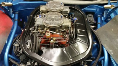

Thanks. Scoop comes of base, then base comes off engine mounts all in like 10 seconds for between round servicing and cruise nights if needed.

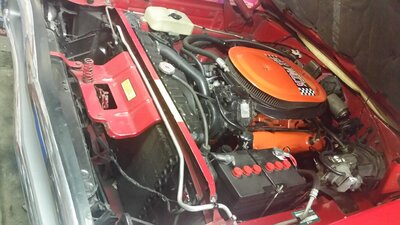

I find that hard to believe that your Weiend six pack tunnel ram will fit under your stock hood. Those are tall. My other car has stock six pack set up with factory air cleaner and the lid rubs the insulation on the bottom side of my hood (factory Cali car) with so called 70 Cali emissions and sound deadening..
