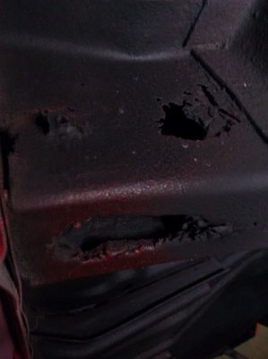

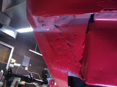

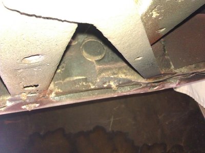

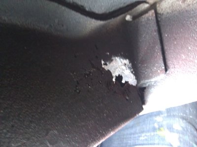

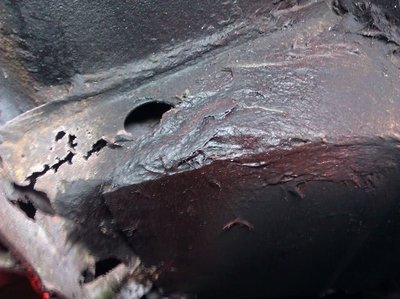

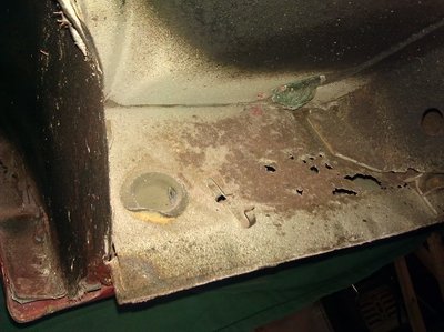

After pulling the rear end of the car I really got under it today and couldn't be more disappointed. She looks good up top, but below I've got a mess. I'm very disappointed in the job the "body man" did on the bottom of this car.
The didn't fix anything. He half-assed dura-glassed or did nothing at all.
I will have all this fixed, but this is obviously a major setback.

I talked to the "body guy" on the phone today. He said "I thought I did a good job on underneath." I can't believe this guy!
I had to call my welder/fabricator father in to save the day (and the car). He looked at it and we've decided that instead of sending it to a body shop we are going to fix up the underbody ourselves. I really didn't want to put this on my old man, but he's going to help me out and I'm very thankful.
I'm not sure what I'm going to do yet about the body guy in terms of reimbursement. Something has to happen, I paid him to do work he didn't do. He's coming to the house tomorrow so I can show him all the shit he messed up, like he doesn't know that he half assed it.
No BS, I pulled body filler caulk out of the rear frame rail holes today. It's all pretty disappointing...
After having my dad check it out I'm confident we can salvage the project and make it right. I wish I would've caught it sooner, it would've been SO much less work. The top of the car looked good, and I trusted the guy. Big time life lessoned learned the hard way on this experience.

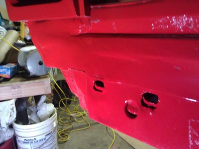

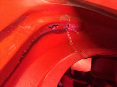

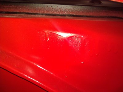

On a side note, I'm pretty sure he brazed-in and fiber glassed the quarter panels in. I'm a bit concerned about it. My dad thinks we should just focus on the bottom and rear end of the car that is messed up. He said the quarters may become problematic down the road, but should last a long time if he did them right. They look good, but after seeing the mess this body guy left me with I have no confidence in anything he's done.
Anyone have experience with brass welded quarters?

I think your father is right, just get the frame good and hope for the best otherwise. Any work now up top will ruin the paint. So...
Just be sure to brace the area and have at it. Might find a chart with the OEM "X" measurments handy.

man that really sucks. I'm sure there not all bad, but I'm starting to rank bodymen right down there with lawyers. I had a "friend" screw up my '68 Charger like that. pulled the trigger, bought new panels, thought I was doing it right.
as far as brazing, the first car I ever had done, guy was an old time bodyman. brazed any patch panel the car needed. never broke out, and looked good for years.

The brazing will probably be OK as long as he cleaned the flux off completely. I seem to remember that some guys use to do something to neutralize the fluxed area too, but I don't remember. But... anyway... yea, work on the undercarriage now and just watch what happens. FWIW, I've seen some brazed panels last a long time.
