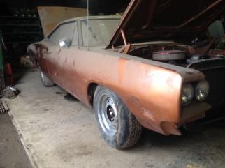

Another friend was helping in the search. Yesterday we went to look at a '69 Coronet 440 that he'd picked up in partial trade for a Dart convertible he sold. After some wheeling and dealing they came to terms and is now officially back as a member of the Ma Mopar club. The coronet 440s don't have the status of an R/T or a Superbee, or even a 500. They don't command the highest prices when completed either. So it won't be going back to original. He'll pick the options that he wants to have exactly the car that he'd ideally want. Most likely it'll get painted B5 Blue with a white tail stripe, twin hood scoops, get a black interior, and a built 440.

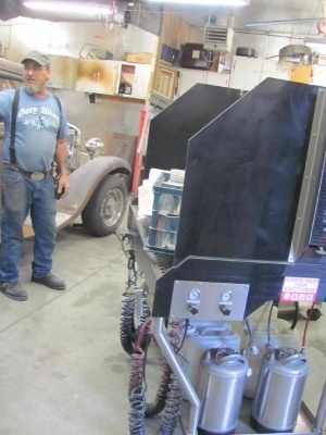

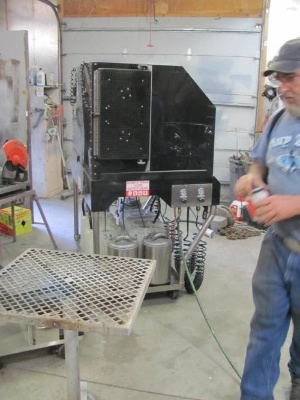

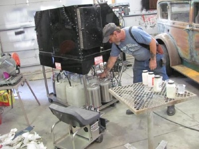

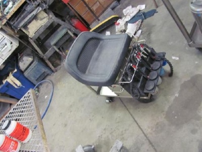

I picked up the Spectra-Chrome system this afternoon. There are not enough chemicals with it to do any plating so I had some ordered by the gentleman that I bought the system from. I want to do some experimenting with it before I order a full chemical kit (around $1600) from Spectra-Chrome. They will not sell the individual chemicals to anyone that has not purchased one of their systems or at least a full chemical kit. I know that I will eventually need to order the full kit from them but do not want to until I'm practiced up. There is a one year shelf life to them.
The guy in the pictures is who I bought it from. I was a bit disappointed when I walked into his garage. I'd expected to be blinded by chrome everywhere. He did show me some examples of things he had done though.
The small roll around chair is part of an electroplating system that was included. I will be able to plate nickel, copper, and gold. While I was there we copper plated a nickel.
I did ask him about the disposal of chemical residues and he said that he had been collecting it for the past 3 years in a 55 gallon drum that he kept outside. Due to evaporation there was less than 15 gallons in it. He said the EPA would definitely frown on dumping it and that I should find someone licensed to dispose of what I accumulate. The stainless steel pressurized canisters beneath the table contain the mixed chemicals to be sprayed. The large white plastic containers are for the waste.
Not pictured is the water purification system and deionizer. He included them with the sale.
He had explanations for each of the problems that I've heard associated with this Spectra-Chrome. And he emphasized that the system is easy to use but the prep is 95%
of the work. All of the sanding, smoothing and refinishing before the spray on chrome is applied is what's necessary for professional results.

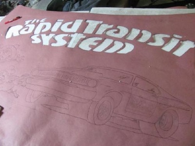

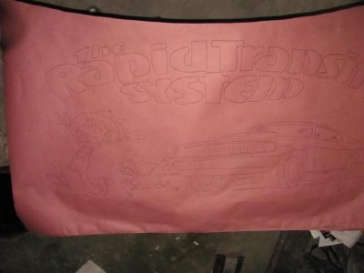

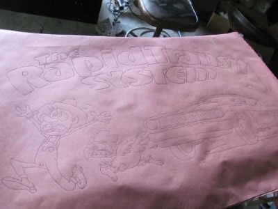

I spent some time working on the design for the trunk mural today. I cut 4 sheets of red 'rosin' paper to match the size of the Duster's trunk lid. Then I played around some more with the sizes of the images I wanted on it. Lastly, I decided to add the old RAPID TRANSIT SYSTEM logo.
It's time consuming but I need to turn the pattern I just made into a series of templates for the air brush. I'm hoping that by making 4 copies of this I can then cut out the portions that I'll be spraying. Different ones will have different sections cut out. By reproducing the entire image I'll be able to align all 4 templates. Keep in mind that it's been a lot of years since I've done this sort of work so the finished design may have a lot of flaws.

When I was young I believed that everyone that worked with air brush painting murals did them freehand. Now I know that some did but most did a combination of freehand and templates. Obviously scallops and lace require the use of a template or screen. I would guess that the best true artists didn't rely on templates as much (if at all). My two favorite artists were Frazetta and Vallejo. I'm no artist. I try to do the best I can with very limited skills.
The way that I'm doing this work I need to cut out the pattern that I made without damaging the surrounding paper. Then I will apply a very light tacky adhesive to the back of the paper and position it where I want to paint it. In these pictures you can see that I layed some sheet Styrofoam behind the design and began cutting out the lettering with a razor knife.
I've got 3 air brushes here now. - A very cheap single action Badger siphon feed, a MAC dual action gravity feed, and a Paasche dual action siphon feed. Most likely I'll be using 1 Shot lettering enamel.
Most of the work I used to do was by pencil sketching directly on the surfaces I was painting and then free-handing over the drawings. I had some decent results and a handful of the vehicles I did won paint awards. But they all seemed amatueristic to me when compared with the pros.

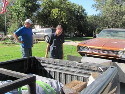

It was errand day today. I finally got all of the plating equipment unloaded from my truck and trailer. It will probably be a few weeks before I get everything set up and am ready to make my first attempt on a part.

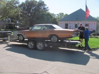

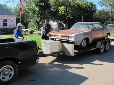

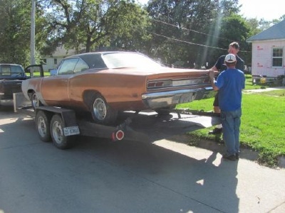

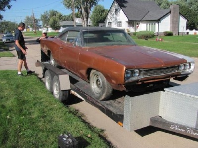

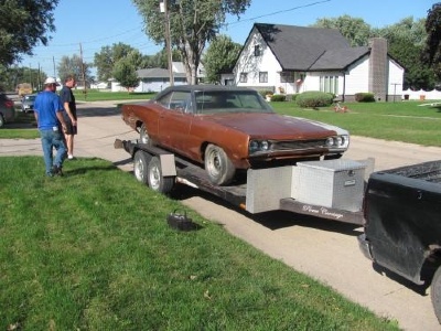

I helped my buddy haul the '69 Coronet back to his home in Seward, Nebraska. We spent quite a while gathering up parts to go with it from various locations. Rather than a simple as is purchase, he was able to get a bunch of other parts included with the purchase. A good large pinion 3.23 posi section, an uncracked original steering wheel, a pair of factory sport mirrors, factory twin hood scoops, a center console, bucket seats, a new replacement right rear quarter panel, and other odds and ends.

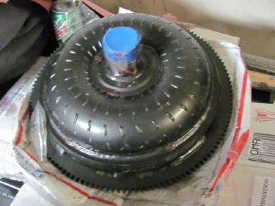

I decided to pull the trigger and bought a TCI stall converter from SBeeMan. The stall speed is rated at 3500-3800. I should start to see some more daylight under the front tires soon. According to the torque curve the 408 produces it should be about right. I hem-hawed back and forth about making the deal because I'd wanted to do more research on converters before deciding. With a big swap meet coming up in Fremont, Nebraska next weekend there was a chance I'd find a better deal. But when he agreed to drop the price I cringed and sent payment.

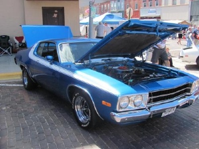

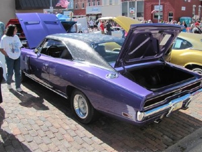

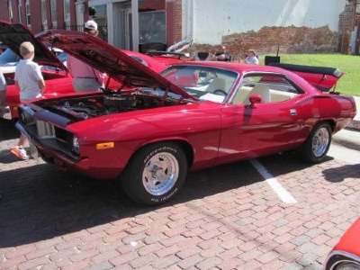

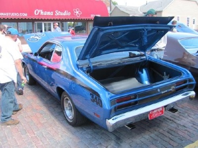

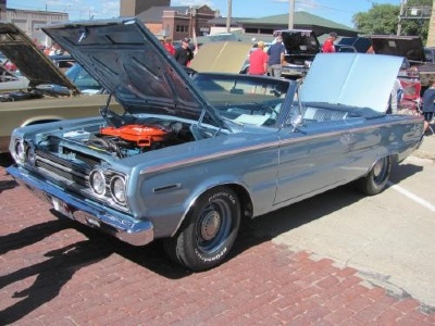

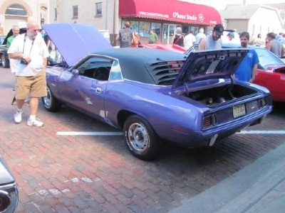

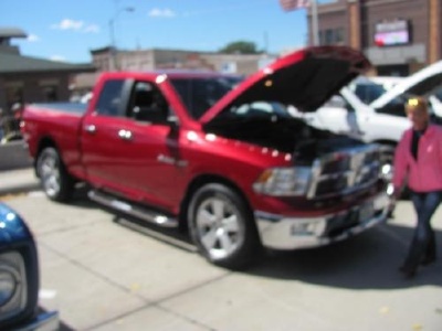

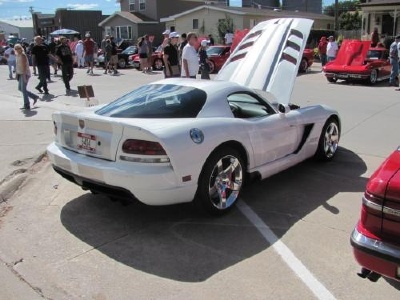

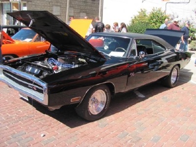

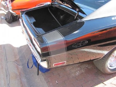

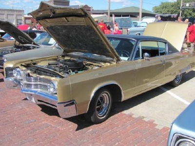

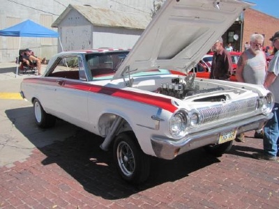

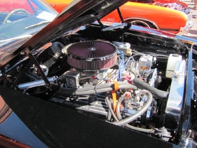

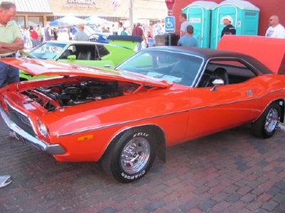

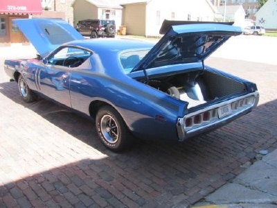

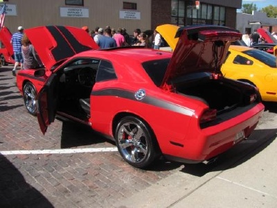

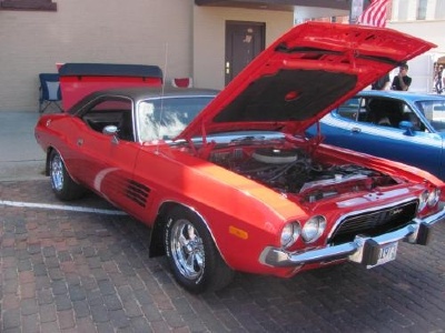

I survived another car show without taking home a trophy. - Of course, I cheated this time by not entering any of my cars. I never caught even a glimpse of Richard Rawlings. I don't know whether or not he showed up but I did see the 'secretary' from the show there. As far as any of the Gas Monkey cars... - well if any of them were there I was unaware of it. They did have that semi truck that they used in their Smokey and the Bandit episodes though.

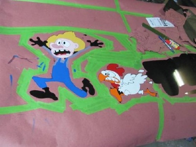

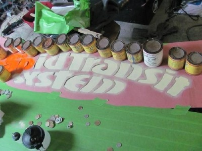

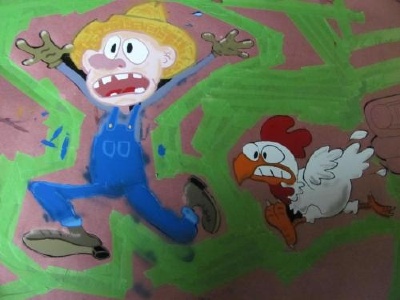

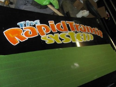

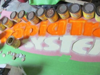

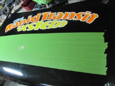

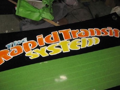

I finally started shooting some paint on the trunk lid. I can tell that I'm not nearly as steady as I was 3 decades ago. Air brushing is always a layering process. Often it's not until all the various layers and details are added that you can really decide whether or not you like your designs. So far it's not exactly impressive. Doing stripes and outlines without a decent pinstripe brush is near impossible. A good clear coat over everything will often add depth and even up the finish enough to help flaws disappear. By the time the rest of the details are added I'm hoping it looks better. If not, - well it's just the drag car and I can always strip the deck lid and start over.

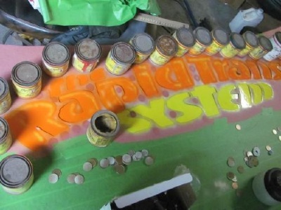

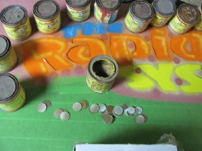

I still need to add some fine black lines between the white and the lettering. I may add in some shadowing yet.

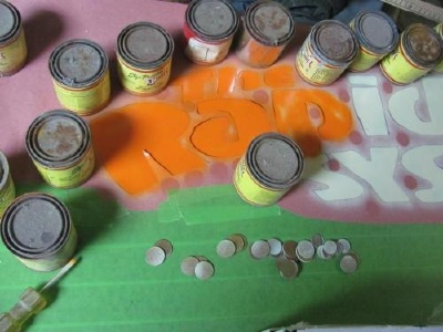

1-Shot Sign Painters enamel never was cheap. I checked the prices on it the other day and about crapped my pants. It's 3 times higher now than when I used to buy it years ago. I read that the new cans aren't as good as the old ones they used to sell. They say that the color holdout doesn't last as well and that it doesn't flow out or self level as well either. I guess they changed the formula because of lead content or something. These cans are all 30+ years old inventory left over from when I used to do sign painting. With the exception of a few cans, - they're still good.
I'd read that they wouldn't have had to change from their old formula because the art application was exempt from regulations, but someone making decisions within the company did anyway.
I was having trouble with the edges of my template lifting when the air hit it so I weighted it down with several cans. I couldn't find an adhesive that would temporarily hold the paper in place. The spray adhesives were too strong and didn't allow me to reposition things. After doing the lettering I came across some glue sticks that are intended for children's school work. I am trying them on the edges of the cartoon image templates.

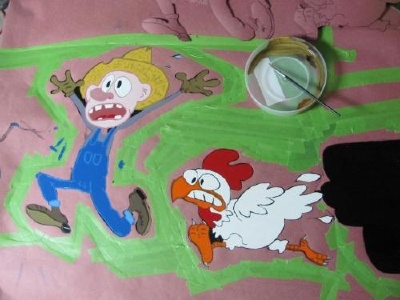

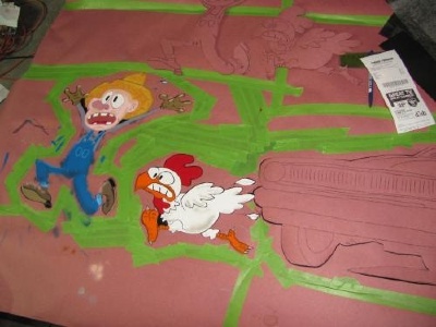

I'm still playing with the airbrush. I still need more detail and have to clean up a few lines. I love the chicken! The picture of the car will be a bigger challenge.

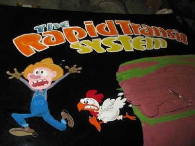

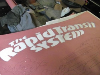

I'm still unsure if I'll put a background behind the image. - Maybe some corn stalks and a barn in the distance...

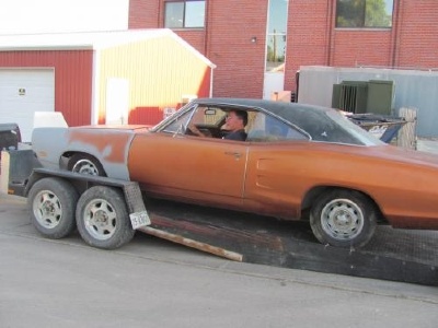

The TCI stall converter from SBeeMan arrived today. I wish I had a transmission jack. I'd like to get it put in later this week. THANKS SBEEMAN!! If it works as well with the 408 that I think it will, - I'll be in 7th heaven! (or at least pointed towards it when I leave the line)
