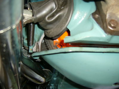

Here are some pics of the carnage:
Here is what I saw while under the car
Driveshaft: Notice the scoring on the shaft.
Bellhousing:
Gas tank - I could fit the end of my thumb in this hole:
Transmission bearing retainer damage - 2 pics

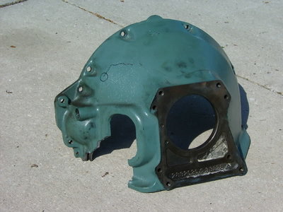

Bellhousing removed from the car:
That circle you see drawn on the bellhousing is where the crack stopped. Yeah - it was a fun night!
I've got lots more pics - but you get the idea.

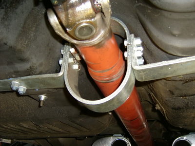

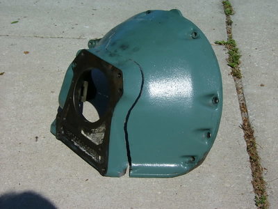

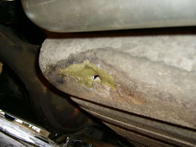

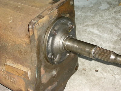

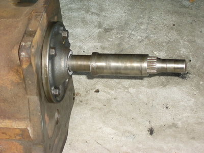

Bellhousing:
