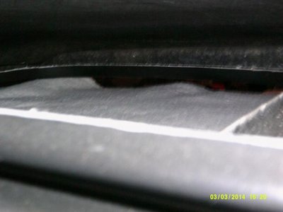

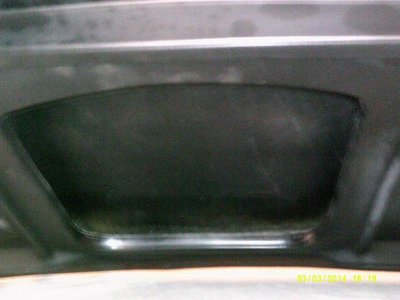

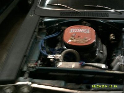

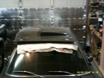

The accurate 69.5 base for the air cleaner to seal to the hood so you get actual ram "cold air" induction, maybe an issue too, with the ones with-out the inner structure under the hood, like the originals or Year One A12 reproduction hoods, the OEM style factory ones, are really pricey, more than you'll pay for a hood...
But there is a company http://www.hybrid-fiberglass-solutions.com/products/standardbaseplates.html that make an "affordable" fiberglass reproductions of the "original" steel ones on the 69.5 A12, but in fiberglass
Anyway good luck with your A12 Clone/tribute project...
