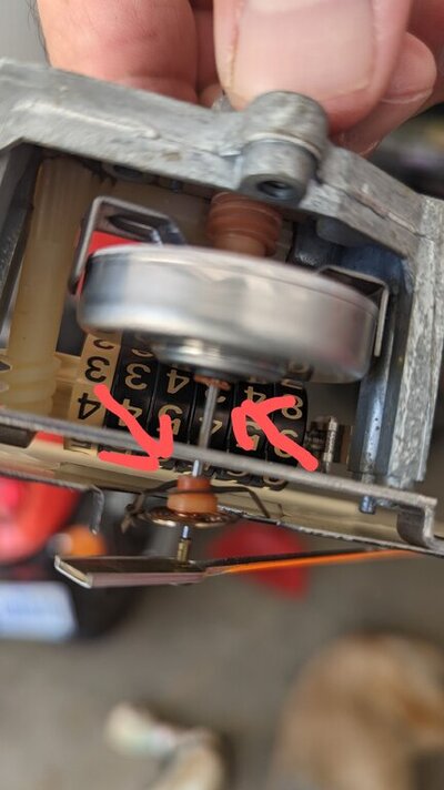

I decided to pull the instrument cluster to look into erratic speedo problems. Despite the cable being unhooked, the gauge did not go to 0. I took an allen key and turned speedo manually. I found that the needle would go below zero and above the max. Digging further i noted the needle was dragging on the plastic face, also. Fast forward to removed plastic face and found what is pictured below.
What risks do I take continuing to tear down the instrument cluster? Having never torn one down, I fear that I will open something and it will unwind like an old cartoon clock with springs and gears going everywhere. Am I safe to continue? Yes, this may be subjective to ones mechanical and electrical abilities. The way I see it, you'd have to have a screw loose or be filthy rich to buy one of these classics, and not have any wrench skills. IMHO :)
Please share your experience and advice. Thanks

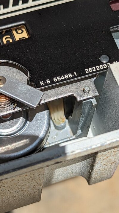

We can ignore the previous picture. I made a poor assumption that the long plastic gear was not supposed to be angled like it is. I tore the cluster down to remove the gauge and found that it seems a small plastic like piece that holds the needle spring in place is broken.
