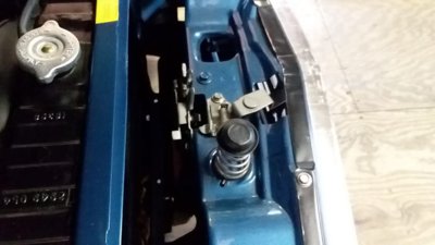

I will send a Pic. I put a rubber cap that I had
Grate TOMRR. Knew someone had a better idea. Than letting the metal spring scratch the paint off the hood. Will be looking for the pic. Russ. :thumbsup2:
:BangHead:Great idea, attention to detail. Long forgot about that bare metal pock mark. Same difference with those painted latch catches, even with new cars. Just one thing: I believe the cap as such will be worn right through after a dozen closures or so. I might use a gasket punch set and make a heavy rubber disc and cement to that spot on underside of hood. Rubber about the thickness of truck mud flaps.
