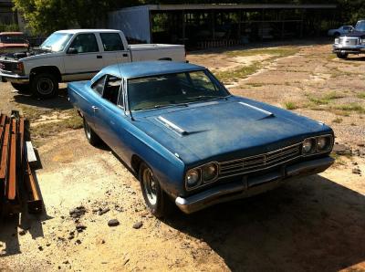

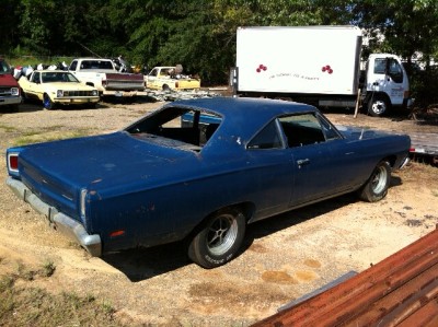

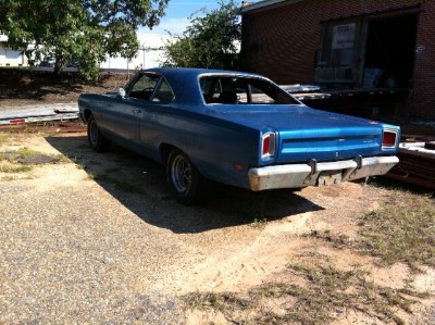

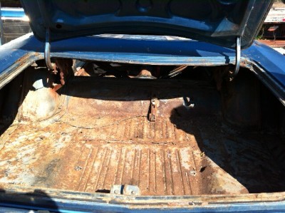

Well the good news is that I was able to look into the rear pillar and see where the car originally had a vinyl top...I found the holes on both sides where the chrome had once been attached and was filled in. So I'm going to assume this is the real deal and the factory screwed up the stamping on the radiator support/trunk lip. Everything else matched up. Heres a few pictures...

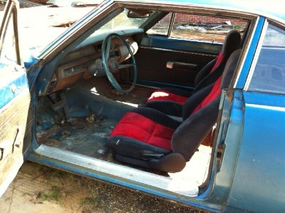

that looks pretty good! :thumbsup: you're not changing the front seats are you? those are killer! :jester:

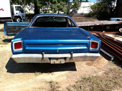

didn't come with them, but I scrounged the bumpers from two different ends of the country and both had them.
Thanks everyone. I'm super pumped. Its solid all the way around except for the lower quarters. Will need to remove those and put in a patch panel. Also the rear passenger floor board has a hole the size of a quarter. Other than that, its a few surface rust spots here and there...one on the front pillar driver's side I believe. Now I've got to clean out 28 years of rats nests in the dash. Was hoping to find a build sheet but no luck so far. Opened the glove box and its slammed to the max with rats nets. Same with behind the dash so I'm sure several wires have been eaten through. But the "Beep Beep" horn still works fine and yes, I does have the "bottom feeder" steering wheel.
I have the original bench seat and rear seats..the current ones in the car are just temporary. I believe I'm going to try and bring this one back to its original glory. ;)
I do believe that's the first runner I have seen with bumperets! :thumbsup:
Yeah I realized that as well. Every picture I've ever seen of a RR is always bumperet-less. So I was pumped to have something unique there...
moparstuart said:
awesome A/C car too
blue with a white top should be a striking color combo too
Thanks. All the A/C components seem to be in place and not messed with. Everything behind the dash is just like it was from the factory..nothing hacked apart...or wires spliced, etc. Only thing missing is the compressor.
