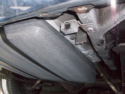

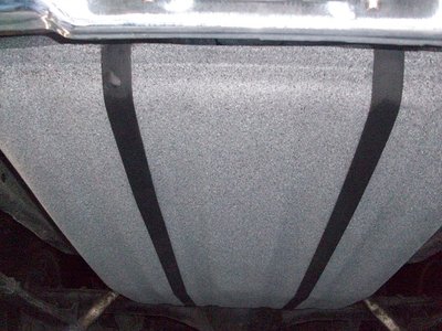

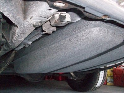

You will need two straps, two J-bolts and nuts, fill tube and grommet, and one insulations pad that is lace between the tank and the trunk floor. I have attached some photo's of my tank I just install two weeks ago.
Jeff
