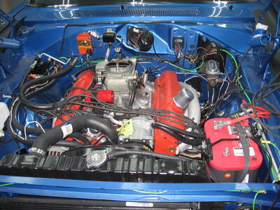

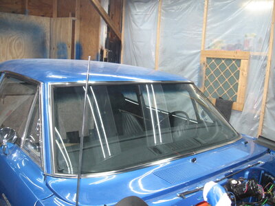

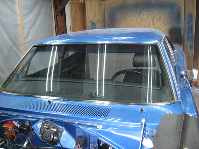

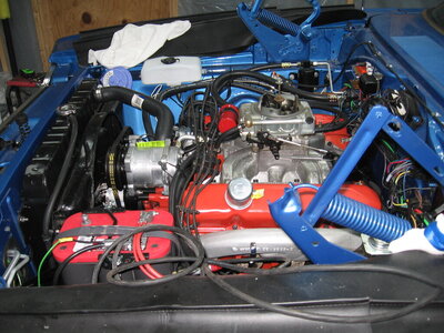

So here is an up date on the front Windshield and a few more pic's of engine bay now. Got new gasket in and had to cut on the glass. Took an 1/8 inch off the bottom first thing and off the sides. Then had to trim the top at top outer corners. We took over a 1/4 inch off it over all. Still tight so to another 1/8 off bottom and some more off the top of glass. So it went in. Trim on happy camper now. Had the A/C charged and it works fine also. Thank you to those that offered advice and tip's. Russ. IMG_0101 (5).JPG IMG_0102 (5).JPG IMG_0103 (4).JPG IMG_0104 (3).JPG
Things are looking really good Russ, it certainly has been a journey. I’m really excited for you so get some video posted when it’s running.
Looks great Russ. I'm sure you are proud.
Yes Russ Hood. One more thing down. Trying to get the brake lines bleed and all the leaks sealed up. Then on to adjusting my driver's side window so the door will close right. Those stainless steel linens sure like to leak at the fitting's. Then have to get a meter match to get the gas gauge to read right. But a lot closer every day. LOL.
