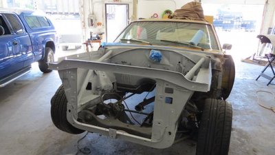

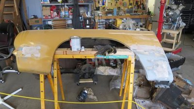

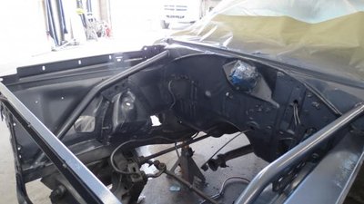

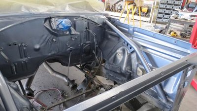

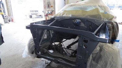

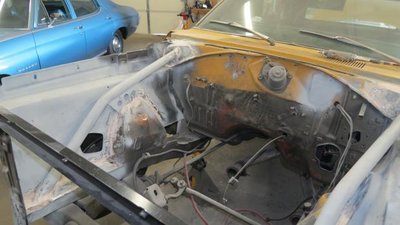

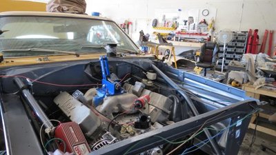

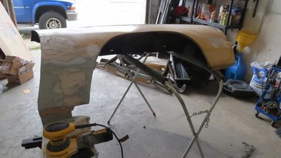

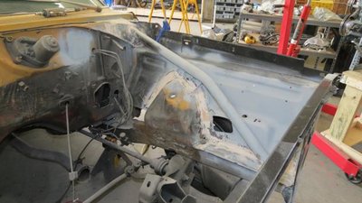

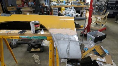

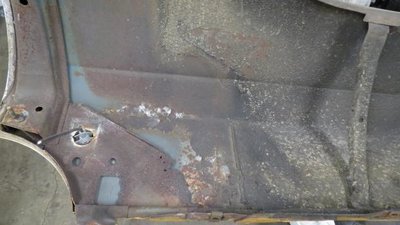

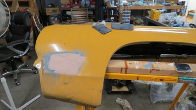

okay, progress update. shock tower braces are in and engine compartment has been completely emptied and started getting the panels ready for paint

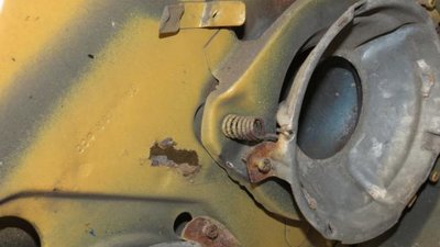

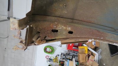

next step has been fenders as well. found a lot of rust on the passengers side at the bottom of the rear brace
IMG_1745.jpgIMG_1745.jpgIMG_1746.jpgIMG_1747.jpgIMG_1748.jpgIMG_1749.jpgIMG_1750.jpgIMG_1751.jpgIMG_1752.jpgIMG_1753.jpgIMG_1754.jpgIMG_1755.jpg
still need to degrease the firewall and get it ready but getting closer to paint time.

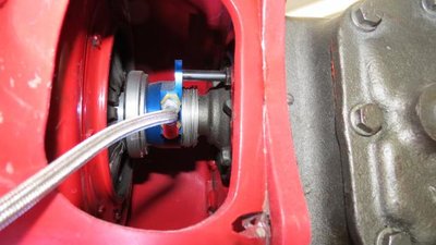

during this week also got the transmission reattached to the engine and installed the new hydraulic throwout bearing
If the weather cooperates I hope to have painting done by end of nextweek.
To date I have used up 4 rolls of welding wire, two tanks of welding gas and umpteen flapwheels and grinding disks on this stuff. just a progress report

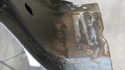

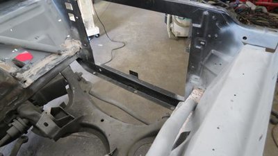

Your VIN# is stamped on your old core support...did you save it? Maybe you could graft that section back into the new core support...
quikbird
3,294
1,101
Sarasota, florida
I do still have it. I did use some of it to make the repair pieces for the fender brace. Where is it stamped on it?
300
either on top as you're looking down, or towards the radiator.
quikbird
3,294
1,101
Sarasota, florida
I did not mess with that part. Will check tomorrow and see if it is there. Not sure if current core support is original
quikbird
3,294
1,101
Sarasota, florida

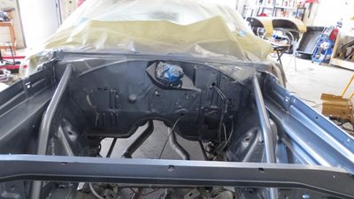

checked core support. no vin found anywhee on it. I suspect this might be a re[lacement piece. I did manage to get the engine compartment painted over the weekend

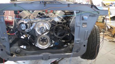

well, didn't get much done this weekend. Just had to go to the goodguys show in Columbus. did manage to get the new wildwood distribution block installed and the line lock and start running the brake lines. will post photos when I get that done. should be this week.
quikbird
3,294
1,101
Sarasota, florida

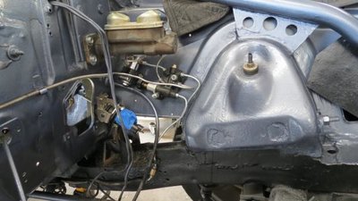

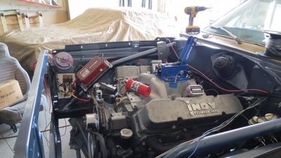

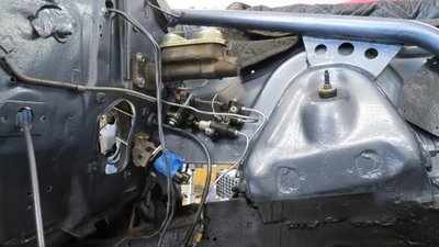

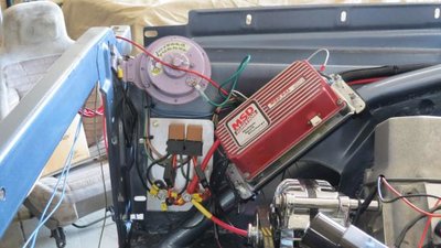

here we go. brake lines installed, master cylinder for clutch installed
engine and trans are back in car but no pics of that yet

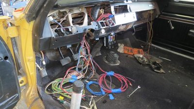

if I could take the next four days off and just spend them on the car I might make it. It's that darn job stuff getting in the way, also that job stuff for the friends helping me. we still have fenders to hang on new inner fender sheet metal which will probably take a day to get right plus all the wiring to finish. all that rust repair a couple months ago just ate up too much time. I will however be at the nats. just driving the truck instead.
