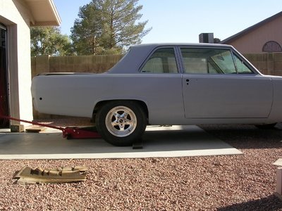

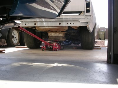

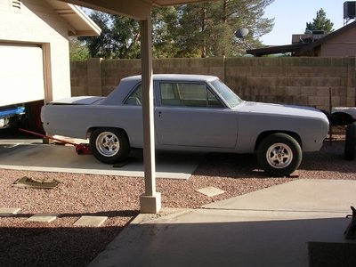

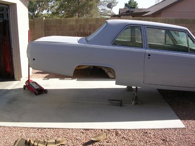

So I pulled the diff and notch the frame rails for the spring relocation and with my spare time I set the car down on a set of BFG P275/60R 15 drag radials that came on my wheels. It will need a mini tub for a tire this size to work as the sidewalls rub if I drop the car much farther. I rolled one of the front wheels up for a look, the tire is to tall for the front but it sure hides the 13" thats behind it :lol:

You should jack up the front and take a pic so we can get some idea of what it will look like once the straight axle goes in... :D
hardly looks like a Chevy ll at all from that angle...... :basketcase:
