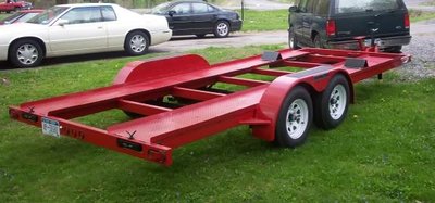

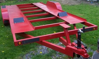

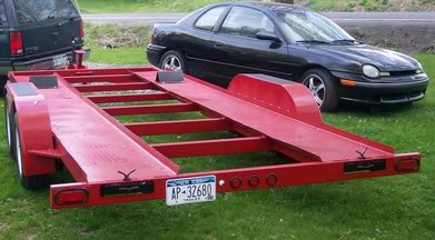

Here's what I have now. This is an Eliminator trailer that they make locally. It tows great! I had it made with 7 foot ramps so I can get a Corvette on it with no problem.
The biggest issue I have is the rear of any trailer I have will scrape when I back into the driveway. My driveway dips down from the road quite a bit. They made it worse a few years ago when they raised the roadway. In fact, I had to raise my mailbox 8 inches. My worry is I buy a trailer that I can't back into my driveway!

Most trailer manufacturers make wheels for the rear of the trailer to help in these situations. They are called Bogie wheels. Nice trailer by the way. If you get rid of it you will miss it. I borrow a friends open trailer all the time. Its just easier for around town.

If this trailer drags, then there is no way an enclosed will go where you want it. They are very low in the back. Maybe some kind of caster wheel on the corners?

Yes. I think the bogie wheels might just do the trick. There's a lot of little things you can do to minimise the angle going in. Biggest problem everyone else has when they try to back their trailer in my driveway is they have the trailer nose angled up rather then the trailer riding level.
