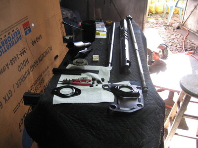

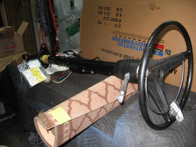

Don't forget to get the rubber O ring that goes between the retainer plate and the fire wall as well as the fire wall gasket. Mark where your big spline is on the shaft and coupling. For steering wheel and the steering box. Will need a snap ring puller for the one under the nut on the steering wheel. IMG_0102 (3).JPG IMG_0103 (2).JPG I did buy a new turn signal arm mine was the pit's. Made it look so much nicer when done. :thumbsup2:

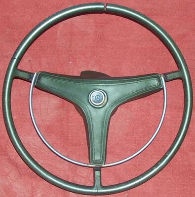

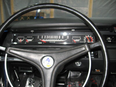

Quick note replace my steering wheel with a the 70's style one. Mine was in really bad shape. It did not look like a runner to me with out this type of steering wheel. Was worried it would not enter change but worked out fine and with the wheels straight forward it is in line so the steering wheel lines up grate in the car like it is suppose to. IMG_0104.JPG

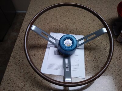

My original wheel is like that one except the horn ring is a
full circle. But that wheel is trashed. So I got this restored one off ebay:
