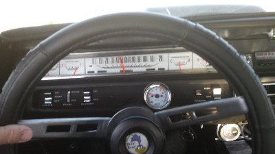

I removed the ASHTRAY........made a pod out of fiberglass and faced it with vinyl to match the dash. Put two 2" gauges.........one for WATER and the other OIL PRESSURE. Works and looks OK to me.................
