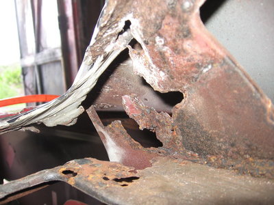

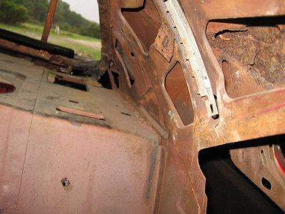

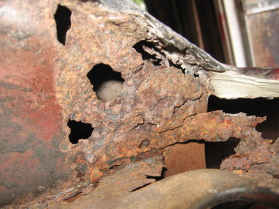

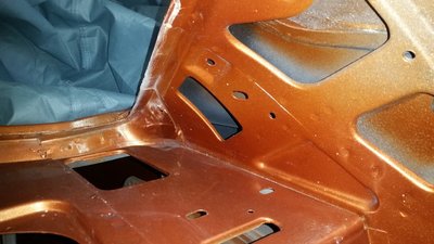

Hello all you bird lovers as you know that I am restoring a 69 runner. I am at the package tray area and filler panel. So much is rusted away where the corner filler goes that a lot of the frame structure is gone. Dose the corner filler weld to apart of the structure or dose it become apart of the structure. If any one has pic's of this area would appreciate it. Russ. :)
Only if I could find it. The metal behind the corner filler is rusted out and cant figure if it had a lip on it from the outer skin or it had a lip on it to weld part's to. Looked all over U Tube but no one has pic's of this area that is clear enough to see how things went together. Russ. :realcrazy:
It was fairly recent, and by recent I'm thinking about 4 months ago, car was blue I think but he had some good pictures of that rear shelf area and how it went back together that you would find helpful

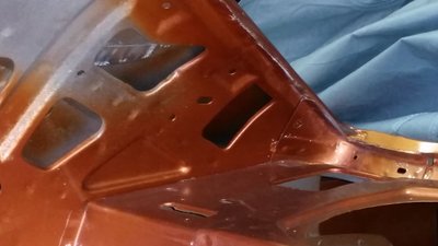

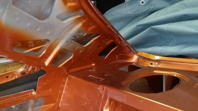

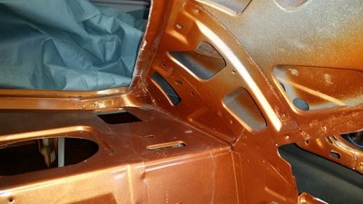

If you need some detailed pictures my cars sheet metal is done and there is no interior in it yet. Send me an example pic of what you want and I can duplicate it.
IMG_0101 (1).JPG IMG_0102 (1).JPG IMG_0108.JPG Here are the pic's of where I was talking about. Where corner filler's should go above package tray extension's.
I know there are some support pieces come up from wheel tubs but that is about all I know of this area
Hey Russ I don't know if they make those pcs but if they don't it's metal you can make anything and it will not be seen either when you get your interior done
