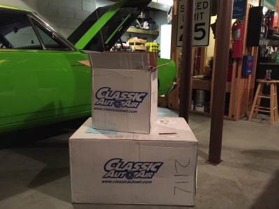

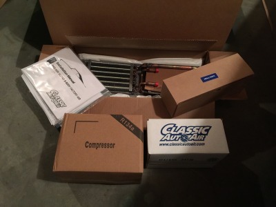

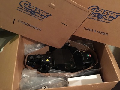

The correct heater core came in today. Now I need to follow up to see where the classic car shop guy is on getting that A/C kit for me.

I was able to get a special order put in yesterday, but it's going to be at least a month before it gets shipped.... at least I've got the heater core leak stopped for now. I could go ahead a pull and replace the heater core, but I'd rather get it all done at the same time. At least I was able to get one ordered. Now it's just a waiting game.
