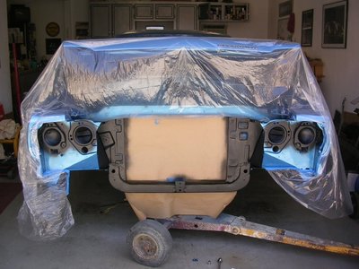

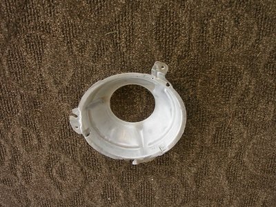

The headlight buckets should be zinc and this is the blackout I did on mine.
