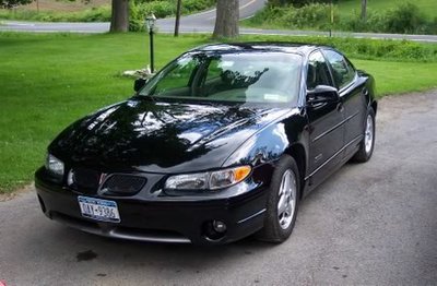

My last black car was my Grand Prix GTP. I brought the paint on this one back from the dead. Somewhere along the line someone used a buffer the wrong way and almost destroyed the paint. A lot of time with 3M swirl remover got it looking decent and then a couple coats of Zaino to keep it looking good.

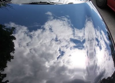

Obligatory "clouds in the hood" shot.
If you want to go black (God, I love black cars) you have to step it up to another level. You can't buy stuff off the shelf at Walmart anymore. You need to look at either Zaino or my new favorite, Adams polishes. Zaino is probably a better product for black cars, with their Z-8 spray being just about blinding. IMHO,Adams stuff is a little easier to use and I like their customer service much better.

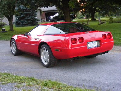

Any chance that this is what you are talking about?
