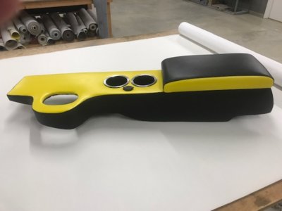

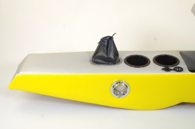

I found an aftermarket console company that has a variety of functional (USB charging port, cup holders, storage compartment) reasonably priced units.
Right now I am going to be the Guinea pig for this console, that is designed for a floor shift automatic B body.
I am going to indicate the required changes on a mock up unit they are sending me in order for it to work with a floor shift MANUAL transmission.
Various colors and styles.

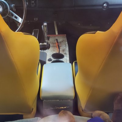

I got the prototype console in my car, but I need to get the car out of the garage to have some room to work with it.
I am concerned that the straight, no console shift lever may not be able to work, but the goal is to see if that is possible while retaining enough height for the cup holders and storage area, and not to be at a weird looking angle.
I'll post a pic once I ask permission from the manufacturer.
Figure the manufacturer would love for you to help sell the product. Just wonder how that the shifter would work out. The console has an off set shifter so it will line up with the console. Got mine form Tony's. Good luck. Would love to see it in the car. :thumbsup2:
In and around 1500. Yes lights-top plate- bracket's- shell- side cover for the hump. I got a few deal's here and their. All the one's on Ebay that where used where junk. Oh and top boot for shifter and lower boot. Plus the shifter. Yes it went on and on but have it all now. Well let us know how it work's out for you.
I cut 1 1/2" of length off the front of the prototype console, and 1 1/2" of height off of the height of the storage compartment. Both of those adjustments were to bring the horizontal bulk of the console down closer to the hole in the transmission tunnel where the shifter mechanism is.
The goal is to make this unit work WITHOUT having to buy the hard to find and expensive "console shifter" on top of the cost of the console itself.
I had to add back in about 1/3rd of an inch to the height of the rear of the storage area as a spacer underneath to bring the console to a level plane.
Here's one picture.
So how is the shifter working. Will it move enough to select the gear's. Just asking. It is grate to find a replacement console. Hope every thing works out for you. Keep us up on how the progress is going. Russ.
I made measurements and recommendations to the manufacturer for the factory 4 speed, basically shifting the hole to the right and slightly rearward. Since I have a Passon Performance a855 5 speed, the hole is going to be moved further to the right on mine since R and 5th are to the right.
It's probably going to be 5 months or so before I get the finished console, but I'm stoked to have it, and not have to buy a $360-$500 console shift lever.
